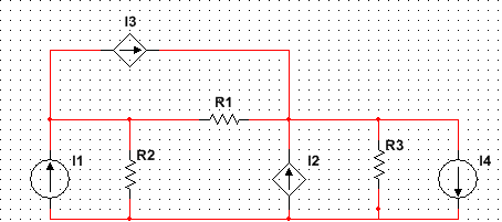

a)Write two node equations in terms of the literal variables.
I1 = Is1
I2 = gm2Vo
I3 = gm1Va
I4 = Is2
Va = Voltage across R2
Vo = Voltage across R1
Vb = Voltage across R3
I tried setting up nodes right above R2 and Right above R3 but it didn't work. I'm really unsure how to approach this problem as our professor only gave us basic examples and our textbook doesn't really have good examples...
Va(G1 + G3 - gm1) - VoG3 = -Is1
Va(-gm1 - G3) + VbG2 + Vo(G3 - gm2) = -Is2

Celostrophus,
You seem to have trouble setting up node equations. So why don't you try again by writing the equations with all components that touch each node on the left side of the equation, and the voltage/current sources plus the voltages from the other nodes on the right side of the equations. I will give you the first one.
Va(G1+G2)= I1-I3+VoG1
Now, you do the second equation for Vo. We can fill in the dependent current sources later. By the way, are you sure that I2 and I3 are defined correctly?

Are there particular polarities associated with these potentials across resistors?
While it may be only slightly dubious to assume that Va and Vb are associated with the node voltages at the top of R2 and R3 respectively where, by convention, the bottom rail is assumed to be the common (ground) node, we're not given any such 'hints' for the potential across R1.
