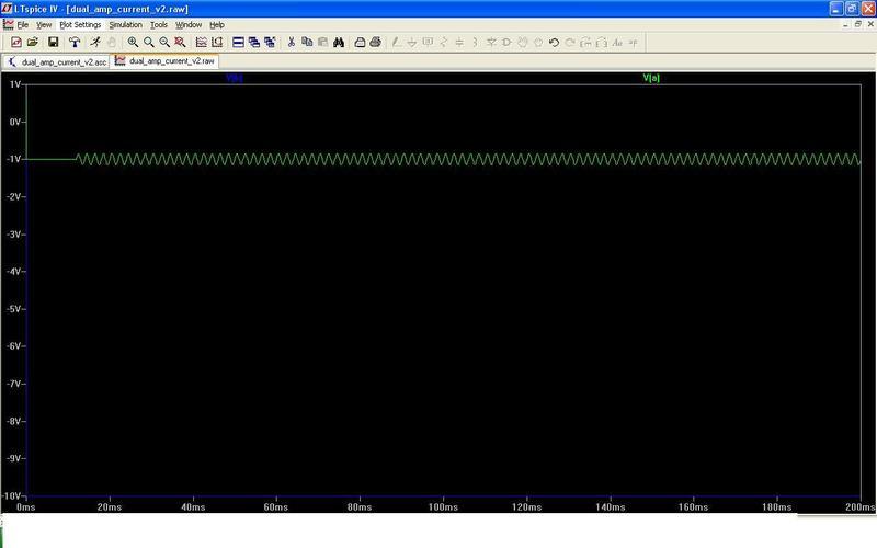

    Hello
    I need to do some simulations before trying to make a real circuit. I was advised to use the free software by Linear Technology. However, it works bad.
    I have a circuit with a couple of operational amplifiers(op-amp). According to the first golden rule, an op-amp should keep equal voltage on both inputs. However, it does not do it. As a result, a simulation data is wrong.
    Can you suggest me another software? Also, Why can it be that the program doesn't work appropriately.
    Thank you, Plantis

  9. Jan 22, 2012 #8
    You can find scheme and simulation attached. Thank you
    Simulation.jpg - Voltage for point A and B(inputs for U2 op-amp)
    pdf file - scheme
    Plantis

  11. Jan 22, 2012 #10
    vk6kro
    User Avatar
    The opamps shown have very low gain because of the low feedback resistor sizes.
    Gains are 0.01 or 1/100 and 0.0005 or 1/2000. This would be why it isn't working very well.
    The feedback resistors need to be higher and you might start with 100K resistors or higher.
  12. Jan 22, 2012 #11
    jim hardy
    User Avatar
    2018 Award
    make it work DC-wise first ?
    what must U1's output be to force his -in equal to +in?
    can he develop that across R6?
    if not, designer has failed to surround U6 with a circuit that lets him force his inputs equal.

  13. Jan 22, 2012 #12
    vk6kro
    User Avatar
    It has a lot of problems at present, but first, the feedback resistors need to be reasonable.
    Then there is the effect of two large voltage sources, V4 and V2 in the input circuitry.
  14. Jan 22, 2012 #13
    The one thing that bothered me was that. That 50 Ohm resistor in feedback, too small. But I thought "oh what do I know" :D
    The standard 741 op amp can give out 20 mA if I recall. If he did put that 50 ohm resistor in feedback, wouldn't op amp fry? Not to mention that 100 Ohm resistor. Am I any close to right here?

  19. Jan 22, 2012 #18
    jim hardy
    User Avatar
    2018 Award
    i think it'd work if R6 were clipped out, or value increased .
    R6 loads U1 opamp to point it cant make feedback to balance V2
    which lets V4 push U2's output negative...
    do you suppose simulation models that?
    i was hoping OP would try it out.
    but i dont know what those numbers inside SINE(?) argument mean.
    teacher pulled a sneaky trick with those diodes, they're both reverse biased unless the sinewave is pretty big..
  20. Jan 22, 2012 #19
    vk6kro
    User Avatar
    I wouldn't worry too much about R6. The opamp type is not given, so we assume the opamp can cope with a 100 ohm load.
    Assume that the output of U1 was -15 volts, follow the path R3, R4, R2, and R6. Because of V4 there will be about 0 volts on the input of U2. So it could work like that.
    The sinewave is ZERO cycles of 500 Hz sinewave of amplitude 1 mV peak and a DC offset of 10 mV.
    I would set the number of sinewaves to 5000, increase the top feedback resistor to 33 K and try it.
  21. Jan 23, 2012 #20
    jim hardy
    User Avatar
    2018 Award
    ""The sinewave is ZERO cycles of 500 Hz sinewave of amplitude 1 mV peak and a DC offset of 10 mV.""
    perhaps not mv but ma? I took that symbol to be a current source... else it shorts out the cap and resistor in parallel with it.
