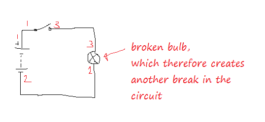

Hey, Do you understand how to draw circuit diagrams? If so then you're best to draw the circuits (doesnt have to be a piece of art or anything) just so you can see what's going on, then draw in the values you know.
I have attached a drawing of your first circuit (a),
No electricity can flow, because there is a break in the circuit,
Lets say your battery is 9v,
The potential difference between point 1 and point 2 would be 9v,
There is technically no potential difference between point 1 and point 3, if you got a voltmeter and put 1 probe on point 1 and the other probe at point 3, the reading would be 0v as there is no potential difference
There is also no potential difference between point 2 and point 3.
If I closed the switch, there would be a potential difference across the bulb BUT no current flowing as there is a broken bulb, no current can flow through it, but the potential is there. If the bulb was okay, then the current would flow through the bulb.

But i don't know when there's a voltage drop and when the potential is the same :( especially for the later parts about broken bulbs.
I do know how to draw circuit diagrams
But i don't know what happens at these points- tried using different colours too
Most importantly, i need to know part g and h , and whether an open switch affects the p.d across a bulb- zero or still equals emf? (Assuming no internal resistance of cell)

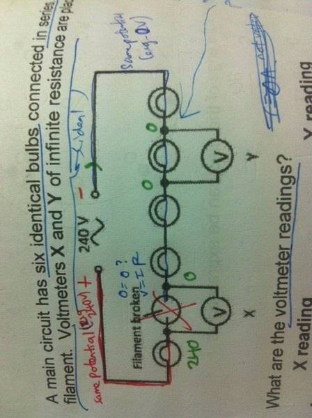

If a circuit is broken in some way, either by one gap or by many, no current will flow so that any component that gets its potential difference thanks to Ohm's Law (V = I*R) will not exhibit a potential difference across it. So now you need to know between what points you will measure a potential difference given that the circuit is open so that no current is flowing.
To find that, first follow the path from the voltage source's + terminal until you reach the first gap in the circuit (open switch, broken bulb, cut wire,...). Everything along that path or connected to it will be at the same potential, that of the + terminal of the source. Next follow the path from the - terminal of the voltage source until you reach the first gap in that direction. Everything along that path will have zero potential. If you placed a voltmeter's ground lead anywhere along the "-" path, and its positive lead anywhere along the "+" path, you will read the potential across the voltage source.
As for the rest of the circuit that may lie between those two gaps, it might as well be erased from the diagram; it has no connection to either pole of the battery and is thus "floating". If either test lead is connected anywhere on that sub-circuit and the other is connected to anywhere on the source-connected portions, you will read no potential.

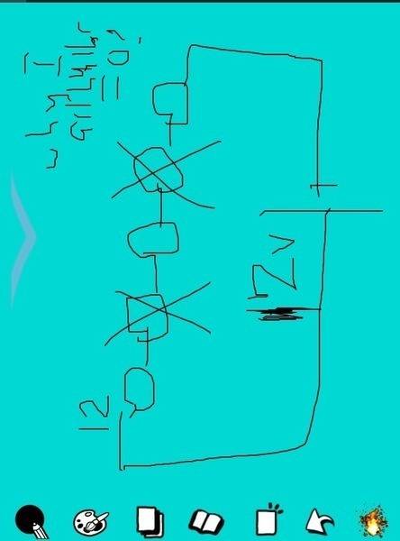

Please pardon my drawing skills
Okay so let's say there's 5 bulbs, bulbs 2 and 4 broken. Counting From LHS. Emf is 12v.
Left hand side of bulb1: 12v
RHS of bulb 1: ( 12- 12/3 ) v ?
LHS of bulb 2 : (12- 12/3) v
RHS of bulb 2 : same
RHS of bulb 5: 0v
I read in a book p.d is zero across EVERY bulb (when 2 or more broken bulbs out of 10 in a series closed circuit) which i don't understand.
I acknowledge p.d across the LHS of bulb 1 and RHS of last bulb,bulb 5 in my case and bulb 10 in the example's case is indeed =emf (when cell has no internal resistance)

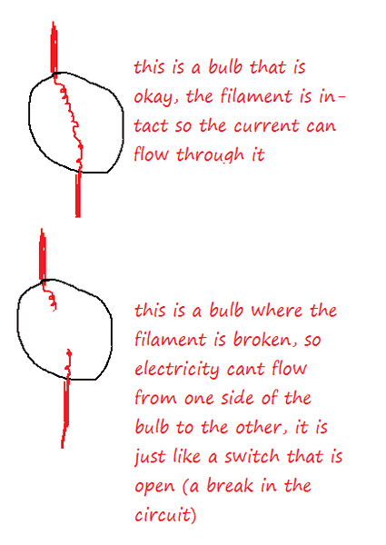

If there is 1 broken bulb in a series circuit then NONE of the bulbs will light as the current cannot flow because it is stopped at the break, there is NO potential difference across ANY of the bulbs for that reason.
See what I attached, that is how a bulb works (a filament one anyway), so basically when the filament breaks, its just like cutting a wire which of course stops ANY current flow

I think i got it from the 2nd last reply and the first reply to this topic :P But Except this case?Answer is C and i got it based on the 2nd last reply :)) Hmph.

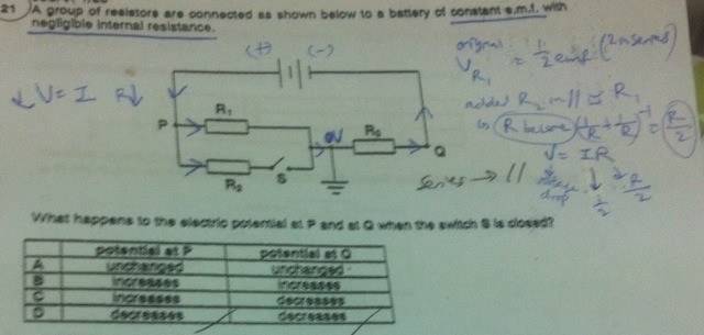

Yes, There is a potential difference over X, the reading would be 240v.
There is no potential difference over Y, the reading would be 0v

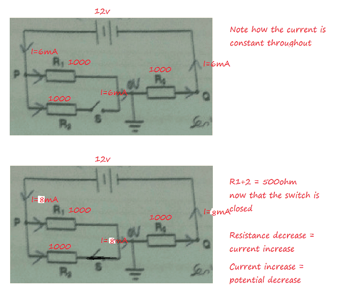

Btw, Why would potential at Q decrease compared to original? Its earthed before that so potential at Q is pd across the Resistor R0 (answer is D)
Also, is it because R parallel is halved only or is it because BOTH R parallel being halved and split(meaning current decreases) of current that potential at P decreases?
I'm not sure why you would ground a circuit where it is grounded but,
The switch switches another resistor in place so the total resistance of the parallel decreases, when resistance decreases, so does the potential,
I'm not sure why the potential at Q decreases, however, I assume it's because the current has decreased going through R0
I think for potential at P it decreases cuz
Both R and I falls- R becomes R/2, I becomes I/2 is it?
For Q i think overall I has increased because of the decrease in total resistance with the switch from series to parallel for the left part---so the potential DROP after the earthing part at resistor R0 is larger (since l falls and Resistance of fixed resistor R0 is constant) resulting in more negative potential hence the decrease than before.
Think you didnt take notice of the direction of current flow. Just thought of these :P correct me if I am wrong!

I noted the current flow, there is no or little actual flow down to the ground terminal as shown in the drawing,
Between positive and ground there should be your full 12v (or whatever your voltage is), and between ground and the negative terminal on battery should be minus something?
When the switch is open, the current through R1 is the same as current through R0 I would have thought, when the switch is closed, that current is decreased, which also decreases the current through R0 thus reducing the potential
What are your resistor values and voltage?
The resistors have the same resistance. It is a general question without values but i think we got it. Except that I am still unsure of the part about potential decrease for P- due to fall in R, I or both.:eek: I think now, that its quite ambiguous because fall in Total resistance actually increases I supplied by cell. Then its hard to tell whether potential at P changes! :0! :9(and i can't say larger current causes larger potential drop thru internal resistance hence reducing terminal pd more because internal resistance is negligible):0 HOw :eek:

I have thrown some values in for an example,
Hopefully that may clear things for you

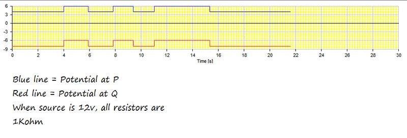

I also just created a simulation of what is happening,
The voltage drop (potential decrease) occurs when the switch is closed,
The simulation shows me opening the switch at 4secs, closing it at ~6secs, opening it ~8secs etc
It did prove the potential at P fell since (increase in I supplied by cell due to fall in R total) is LESS than (fall in R total due to series to parallel change) which meant the v fell since IR fell, but well if no values were given how do i tell? Hmph

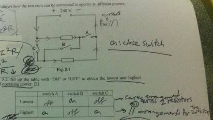

How do i get this? Filled in the answers for easy reference. Dont see why unless i try subbing values again. Seems like a high order application question to me. Least dissipated power: Series circuit with 2 resistors(P=V2/R V larger with 2 resistors by V=I(2R) why :( least dissipated power?)
Highest dissipated power: parallel circuit with 2 resistors. (Half R hence larger I than a normal 1 resistor series circuit-hence P=I2R larger increase in power with the square on I)
How is there a basis of comparison?
"It did prove the potential at P fell since (increase in I supplied by cell due to fall in R total) is LESS than (fall in R total due to series to parallel change) which meant the v fell since IR fell, but well if no values were given how do i tell? Hmph "
Aww sorry i still don't get how to predict the fall in potential at P without subbing in values though. The effect is only seen after subbing because it involves seeing which outweighs
To me, Lowest disappation would be when all switches are open, there will be no power dissipation (aka the lowest) because no current is flowing,
The highest would be whatever switches you need to open/close so that electrons flow through the least resistive path? The less resistance, the higher the current, the higher the current = higher dissipation,
It has to be operating :P i think by just looking at resistance i got it - Highest power because least resistance when 2 resistors in parallel

What you first said is correct, you need to work out which route would use the most and least current
Power dissipation=V2/R
I=V/R
Pretend both resistor values are 1000ohm and the voltage is 12v
Calculate current flowing where;
Both resistors are in series
Both resistors are in parallel
Only 1 resistor is in circuit
The route which uses most current is highest power dissipation (so work out your switching combination to get that route done), then the same for lowest power dissipation.
