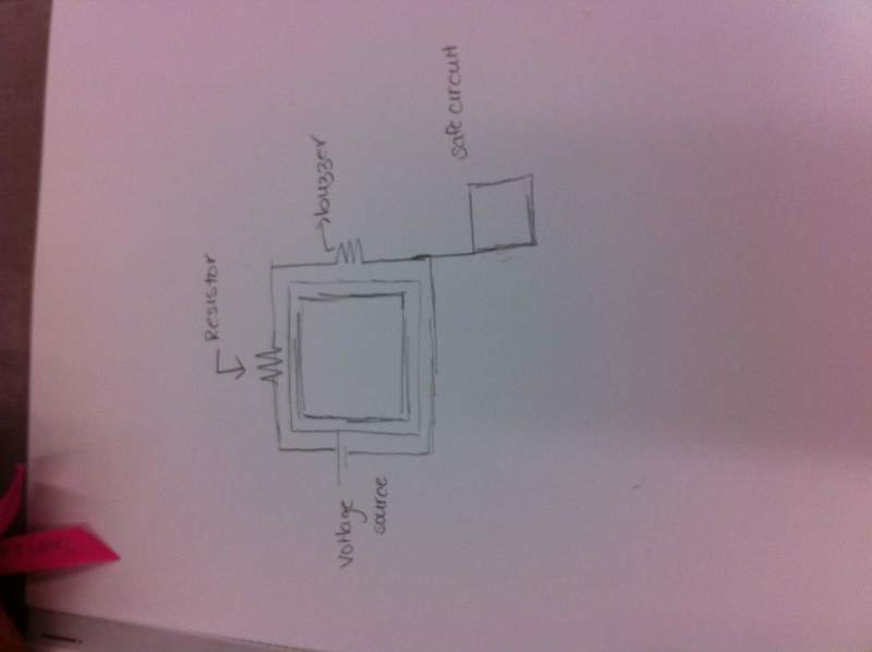

I'm somewhat lost as to HOW to make it. My thinking was to use the 100 ohm wire to surround the window. The buzzer would be parallel to one side of the window and the voltage source will be parallel to another side of the window. There will be resistors in series in between the wire connecting the buzzer and the voltage source.
When someone breaches the system, shouldn't the voltage drop through the resistors?

I'm sorry if this isn't glaringly obvious to me...circuits isn't my strongest suit. I'm doing good in all courses (As and Bs) except this. I'd like to develop more on the idea of having a circuit around the widow connected to a small safe circuit.
I drew an outline as suggested above:
Your circuit sounds the buzzer constantly :)
A 'safe circuit' connected at one point cannot alter the operation of your window circuit. The current flowing through the buzzer is controlled by the voltage across the buzzer, which is set up by the battery connected across it (and the resistor). A handle on one point that can raise or drop the absolute voltage of one side of the buzzer cannot change the voltage across the buzzer set up by the battery. The battery has one terminal connected to that point and then adds a voltage to that at the top terminal, to set up the voltage difference seen by the buzzer.
To interrupt the buzzer, a 'safe circuit' would need to either alter the voltage across the buzzer (which requires a handle on two points) or physically detach the buzzer to break the circuit. You do have a means to physically break the circuit -- the broken wire -- but if you placed this window wire in series with the buzzer, your alarm system will not work as intended. The circuit under normal operation would constantly sound the alarm and only stop when the wire was broken.
So you should look at how to alter the voltage across the buzzer. There are two ways to do this: one is by connecting something in parallel (for example, what happens if you attach a piece of wire across the buzzer) and the second is by inserting something in series (for example another battery) that reduces the voltage across the buzzer. One of these ways is going to be more power efficient and may not be doable given the materials you have to work with but you should look at both just to gain a better understanding of circuits.
