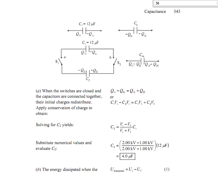

A 12-μF capacitor and a capacitor of unknown capacitance are both
charged to 2.00 kV. After charging, the capacitors are disconnected from the
voltage source. The capacitors are then connected to each other⎯positive plate to
negative plate and negative plate to positive plate. The final voltage across the
12-μF capacitor is 1.00 kV. (a) What is the capacitance of the second capacitor?
(b) How much energy was dissipated when the connection was made?
For this problem they connected the 2 capacitors as a parallel circuit, I don't understand why it works like that.

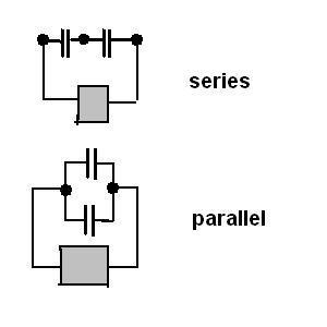

Series or parallel connection are meant with respect to the other part of a circuit. The series connection means that one terminal of both elements is common (and nothing else is connected to this common point) and the free terminals are connected to the other part of the circuit. Parallel connection means that both terminals are common and these common points join to the other part of the circuit. See attached picture.
In your problem, both terminals of the capacitors were common and connected to a voltmeter. The grey block in the drawing is a voltmeter. With respect to the meter, the capacitors are parallel connected.

There is something I have to be overlooking, probably something easy. In the solution manual they drew ceq as Qi-qi on 1 plate and Qi+qi on the other plate, which I have no idea where they got that from. So I thought that's how they applied conservation of charge by setting 1 plate = to the other. But the other plate should be qi-Qi. I attached a link.
ehild said:
It is a misprint in the manual.
ehild
In other words does it mean that conservation of charge for this problem is the magnitude of the sum of charges of 1 plate of capacitors set equal to the sum of the 2 positive charge on the 2 capacitors and NOT one plate of Ceq set equal to the other plate of Ceq?
"Series" or "parallel" designations are not absolute, but are with respect to two nodes.
I just looked at the manual more carefully. It does not say that there is Qi-qi charge on one plate of the equivalent capacitor and Qi+qi charge on the other plate. It is written Qf+qf, which is not consistent with the next equation as it suggests that there are equal charges on both plates. One plate has to be positive, the other is negative. The magnitude of the charge is the same on both plates, but the sign are opposite. The charge is qi-Qi on the other plate, which is the same as -(Qf+qf).
The further part of the solution is correct. It solves the equation Qi-qi=Qf+qf, by using the relation Q=CV.
ehild
