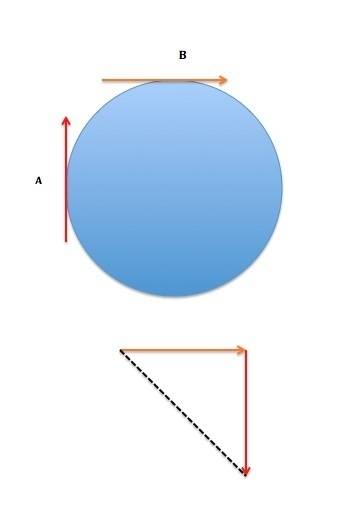

I was drawing the velocity vectors in circular motion to show that, the difference between them would yield an acceleration with direction towards the center of the circle. The problem I am having though is understanding from which point that accelerating takes place. I.e:
A ball moves from point A to B.
I do the vector subtraction and get my change in velocity, my acceleration. Is that acceleration the acceleration at A, at B or at halfway through?

And, I'm not sure if I got this. So, the resultant in my attachment (the difference between the velocity vectors) are my average acceleration between A and B? Like, if I got the length of the arc length between A and B and halved it, the acceleration I got would be there? (It seems to make sense, because, if I do so, my resultant points to the center of the circle)
That would give you the average acceleration between those points, but not the acceleration in the middle. In the limit as A and B are arbitrarily close, you'll get the instantaneous acceleration. (Which will point towards the center.)
Ok, got it thanks! I used to kind of ignore the "infinitesimally small..." descriptions the books give but I have just recognized how they are important! Stupid me :redface:
