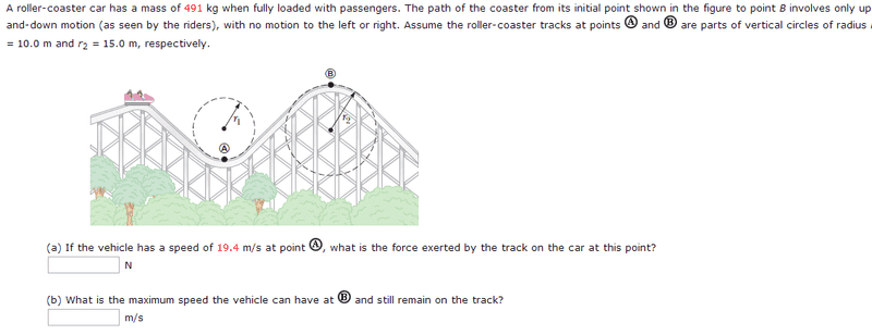

I have found the solution to part(B)
But I don't understand why the centripetal force is equal to the weight of the vehicle when the speed of the vehicle is maximum.

haha1234 said:
But I don't understand why the centripetal force is equal to the weight of the vehicle when the speed of the vehicle is minimum.
Do you mean maximum? The minimum speed would be zero.

Okay. So, what would happen if the centripetal force became greater than the weight?

Doc Al said:
What are the only forces acting on the vehicle?
Centripetal force and tangential force?
No, I'm talking about real forces. ("Centripetal force" is just the name given to whatever force is producing the centripetal acceleration. It's not a kind of force.)
Hint: One of those forces is gravity. What's the other? (I'm only interesting in forces that act at the top of the motion.)

Normal force? But I don't know how they are relevant to the maximum speed:cry:
haha1234 said:
Normal force?
Yes!
They are relevant because those two forces combine to give you the centripetal force.
What direction do those forces act? Express the centripetal force in terms of those forces.
The force of gravity cannot change, but what about the normal force?

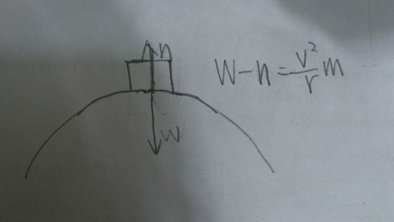

Am I correct?
But when the centripetal force is greater than the weight, the normal force will be smaller than zero.
Is it correct?
haha1234 said:
Am I correct?
Is it correct?
Yes.
Of course the normal force cannot be less than zero. What will happen is that the vehicle will leave the track if the speed is too great. The point where it is going as fast as it can and still maintain contact will be when the normal force goes to zero.
Doc Al said:
Yes.
Why the vehicle will leave the track when the normal force becomes zero?
Sorry for my stupidity.:shy:
As long as the vehicle is pressing against the track there will be a normal force. When the normal force goes to zero, that means it is no longer pressing against the track--if it goes any faster, it begins to go flying off.
