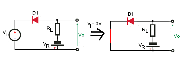

In the given circuit. It was given that when Vi>Vr diode will be reverse biased or off..and when Vi<Vr diode will be forward biased... but I am not getting how we infer this..??It may sound a very basic question but its not clear...I am not able to decide it

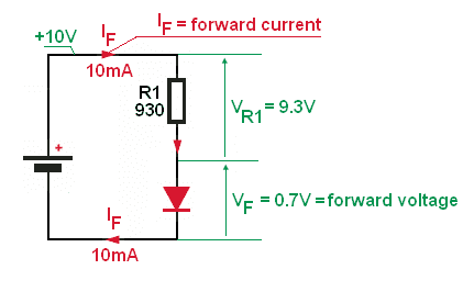

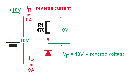

As for the diode. Diode allows current to flow only in one direction (called the diode's forward direction), while blocking current in the opposite direction (the reverse direction).
Forward-biased diode (diode is ON)
Reverse-biased diode (diode is OFF)

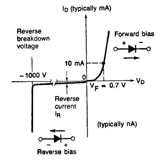

IR isn't 0. It is just small.
Well yes, but I don't want to confuse the OP. And you can read from the first picture the reverse current is typically in nanoamps range

If we set Vin = 0V, then you can replace Vin with a short wire.
So the circuit will looks like this:
And now can you tell me in which state the diode is, ON or OFF? And Vo is ?
It seems to be in reverse bias..!
Yes, diode is reverse biased. But what about Vo voltage? Any clues?
its in rever biase ..so it'll be open , so output V0 will be Vr..>!
no..actually considering the polarity of battery , V0 will be -Vr.

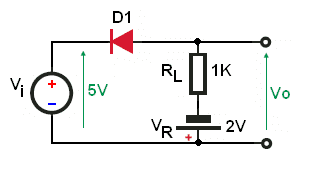

OK, so now let as try to find Vo if Vi is larger than 0V. For example Vi = 5V
The voltage at cathode is 5V and the voltage at anode is -2V. So voltage across the diode is equal to Vd = -2V - 5V = -7V.
And this means that diode is OFF(Reverse-biased) and Vo = -2V.

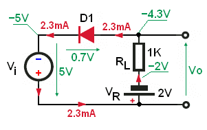

Now let as change the polarity of the Vi voltage source from +5V into -5V.
This time diode is forward biased because Vd is positive. Vd = Vo - Vi = -2V - (-5V) = 3V. And this is why the diode will conduct current.
And Vo = -4.3V.
So we can conclude that the diode will be ON only if input voltage (Vi) is 0.7V voltage lower than Vr voltage.
Diode is ON if Vin < -2.7V

but if we take Vi=1V then diode will be reverse biase even if Vi=-1V.. since Vd= -2-(-1)=-1V..so it will not conduct..!
I did'nt get this point..how can you generalise it.>??
Yes exactly. Diode will conduct only if Vin is lower than -2.7V
What you don't understand here?
When diode conduct, the voltage drop across the diode is around 0.5V...0.7V.
This means that Vin voltage must be 0.7V lower than Vr voltage to force diode to conduct.
For Vr = 2V input voltage need to be lower than -2.7V
