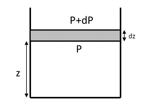

Consider a layer at height ##z##, cross section ##A## and thickness ##dz##. Let ##p## and ##p+dp## be the pressure on two sides as shown in figure. The mass of the air in this layer is ##A\rho \,dz## where ##\rho## is the density of air at height ##z##. Equating the forces, I get
$$\frac{dp}{dz}=-\rho g$$
Now I am not sure what to do after this. From the ideal gas, I have ##\rho=(pm_a)/(RT)## but how do I introduce ##\gamma##? :confused:
Is my approach even correct?
Any help is appreciated. Thanks!

Let the initial pressure be ##P## and volume occupied be ##Az##. When the gas expands by height ##dz##, I have:
$$P(Az)^{\gamma}=(P+dP)(A(z+dz))^{\gamma} \Rightarrow P=(P+dP)\left(1+\frac{dz}{z}\right)^{\gamma} \approx (P+dP)\left(1+\gamma\frac{dz}{z}\right)$$
$$\Rightarrow \frac{dP}{dz}=-\gamma \frac{P}{z}$$
Is this correct?
No, that is not correct. You assumed that ##A## was constant, but there is no reason to assume that. Besides, you obtained the relationship between ##p## and ##z## in #1; it is good. What you need here is a relationship between ##T## and ##p##.
