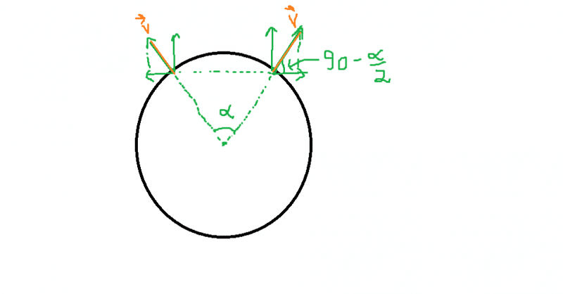

well , at a) after figuring out the scale factor I would find the rate at which the universe is expanding but I don't know how because if I were to find it from Hubble's law , I wouldn't know the Hubble constant because it varies in time. But if I knew it , I would do so: v=H(t) * R ; R is the universe size at recombination time given by R=Ro * S
the speed of light c = 2*v*cos(90-alpha/2) , and form here , knowing v , i would calculate alpha
at b) I would do the same thing as at a) but backwards: if 2*v* cos( 90-alpha/2) >c ( they can't see each other)
if 2*v * cos(90-alpha/2) < c ( they can see each other)
And the v is calculated the same as it is in a) but now we know the Hubble's constant = 72km/s/Mpc, I don't know how we would determine it if we don't know the size of the universe... v=Ho * Ro
Part a of the question is not asking for an angle, it's asking for a distance. Do you have a formula for horizon distance?
Even for part b, the diagram you drew is not what the angle alpha means. The universe is not expanding from a center, so alpha is not the angle between two velocity vectors. Alpha is the angle between two CMB light rays reaching us now; it has nothing to do with velocities of anything.
You can't. See above. First, you need to calculate the horizon distance at the time of the CMB emission, which means you need a formula for horizon distance. Then, you need to calculate, for two points in the sky that appear to us an angle alpha apart now, how far apart (distance, not angle) they were at the time of the CMB emission. Then you can compare that distance to the horizon distance at the time of the CMB emission.
