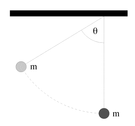

    1. The problem statement, all variables and given/known data
    Two identical steel balls, each of mass 3.4 kg, are suspended from strings of length 27 cm so that they touch when in their equilibrium position. We pull one of the balls back until its string makes an angle theta = 74o with the vertical and let it go. It collides elastically with the other ball.
    A) How high will the other ball rise above its starting point?
    B)Suppose that instead of steel balls we use putty balls. They will collide inelastically and remain stuck together after the collision. How high will the balls rise after the collision?

    3. The attempt at a solution
    I am unsure how to start this problem. I know that the total initial momentum must equal the total final momentum, because the collision is elastic. Can someone help me out by explaining part A and part B?
    I think, the reason u are giving for your assertion is, simply put, WRONG!
    Initial momentum = Final Momentum, if net force in the direction of the momentum is zero!
    Collison is elastic => No energy loss.
    In the part (A).. as collison is elastic, u can apply conservation of energy. (Of course, u have to apply once conservation of linear momentum also.)
    Doing part (A), must give u enough hints to do the second part.

    use your trig skills... so angle is theta, the height would be possibly the adjacent side? You are give the hypotenuse. I think u can take it from there.
  7. Oct 26, 2007 #6
    Initially, height of first ball is R[1 - Cos(theta)], where R is the length of the string and theta is the angle mentioned in problem.
    Find speed of first ball when it is just about to strike second ball.
    When first ball strikes second ball, it has speed in horizontal direction. Apply collision principles to find final speed just after collision of the two balls. And, then get the height attained by each of the balls.
    Note that, tension is always perpendicular to the displacement of either ball, so work done by it will be zero!
  8. Oct 26, 2007 #7
    so I set 1/2mv^2 equal to mgh, and solved for the velocity. I got 1.95 m/s. Am I doing this right?
  9. Oct 26, 2007 #8
    solve the problem totally.. and then seek help. if u ask after every step... it's like being dependent on us and not beieving urself.
  10. Oct 26, 2007 #9
    alright so I did do it right. The initial height of ball 1 equals the final height of ball 2 because the collision is elastic. So how do I approach part B?
  11. Oct 26, 2007 #10
    do it exactly the same way. just be careful, while applying principles of collision. Here, after the collision the two balls are going to stick together. Take this into account for conservation of linear momentum, and u will be able to do it.
  12. Oct 26, 2007 #11
    I tried using 1/2(m1+m2)v2=(m1+m2)gy. I tried solving for y, but I am not getting the right answer. Can you explain where I am going wrong?
