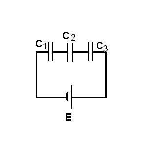

Dear Members,
Kindly go through this link. I read Capacitors block DC then how can the supply voltage Vcc
which is essentially DC can charge the capacitors of the tank circuit? Kindly help members
The capacitor blocks current when it is charged to the equilibrium voltage, but it gets charged. Also, when two capacitors are connected in series to a voltage source, both of them get charged.
ehild
i don't understand sir
See attached figure. Will the capacitor C2 get charged? What is the charge on each capacitor if C1=2 μF , C2=3 μF and C3=3 μF, and E=10 V if the voltage source has been connected for a long time?
ehild
Sir,
According to the formula q = c/v the charge stored in c1 = 20 micro farad and for c2 and c3 it is 30 micro farad
Capacitance is charge over voltage, so the charge is q=CV. And the charge is the same on all capacitors, the resultant capacitance multiplied by the voltage of the source.
Anyway, the capacitor is charged by the DC source, does not it?
ehild
sir, how can we say charge is same on all the capacitors. because q = cv, so c1 has 20 micro coulomb and c2, c3 has 30 micro coulomb charge.
But when the capacitors are connected in series, charges are same. i am confused though i got the concept of capacitors are charged by DC
I got it now sir. Thanks a lot for your link and detailed explanation.
