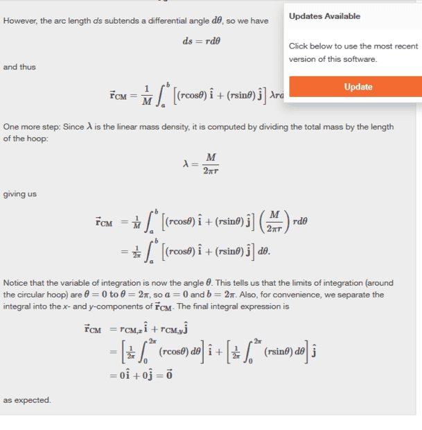

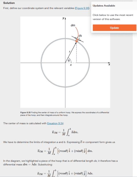

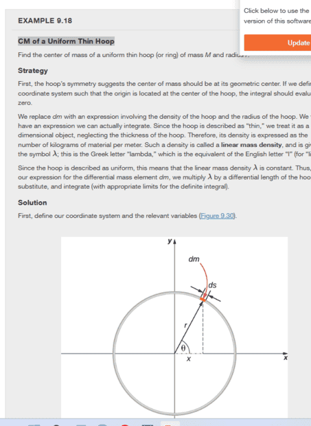

Is there a way of solving this problem without without using polar coordinate's.

Sorry I was not clear. I would like to understand how to solve this problem without using polar coordinate's.

Yep, Thank You.
