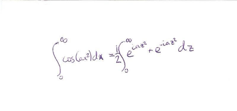

By applying Cauchy's theorem to a suitable contour, prove that the integral of cos(ax2) = (pi/8a)1/2
Cauchy's integral formula:
http://en.wikipedia.org/wiki/Cauchy's_integral_formula
I'm not sure where to go after what I've got scanned. I've tried a few other things, but I can't seem to get anywhere that looks like something I could solve.
Hint: Consider the function exp(-a z^2).
What I do know about eiaz^2 is that within 0 < argz < pi/4 it is analytic and
eiaz^2-->0 as |z|-->infinity
Could I expand that in terms of a Taylor series and use the method of residues to solve the integral? Would this be the correct expansion for cos(ax2):
ex = 1 + x + x2/2! + x3/3!
Taylor series for x = iaz2 added to the taylor series for x = -iaz2
= 1/2(eiaz^2 + e-iaz^2) = 1/2[(1 + iaz2 - a2z4/2 - a3z6/6 +...) + (1 - iaz + a2z4/2 + a3z6/6 +...) = 1/2(2) = 1?
and then would I express 1 as a complex exponential?
Is that right?
