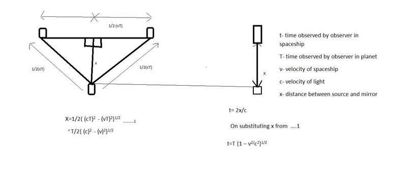

hello phinds
I have attached one picture to this and i tried to derive equation for time dilation from that.
please see and tell whether it is right or not ?
  • #52
svijay1991 said:
hello phinds
Looks right to me, and not surprizing, since it's the standard formula although I think it's normally expressed in terms of T, not in terms of t
