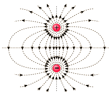

Here's pic of E-field lines you're interested:
One can clearly see where horizontal component of E-field dissapears.
