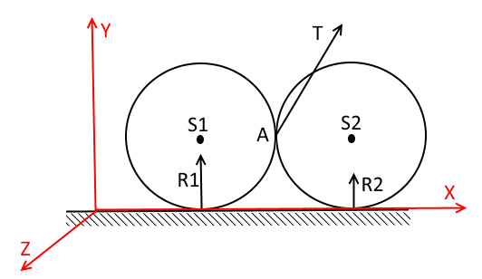

1. A moving rough cylinder of radius a, and mass m collides with an identical cylinder, on a smooth horizontal surface. Its centre of mass moves with linear velocity v0, and its angular velocity is ω0. What is the motion of the cylinders after the collision?
I have be told that the answer to this problem does not involve using conservation of angular momentum because there is an external torque during the collision, and the way to do it is using conservation of rotational energy. I do not understand why angular momentum is not conserved if you consider that it is a closed system.
Thanks in advance for help
Since they both have rough surface, it would seem that they stick together at one point. Can you draw out a diagram of what that system would look like? Can you see how the external forces (horizontal surface and gravity) work to create a torque on the new system?
Okay so the new system is now made to rotate because of the torque, which therefore conserves angular momentum?
Imagine these two cylinders floating out in space. One (call it A) is moving toward B (which is stationary and not rotating) and also A is rotating. When they hit, and if the surfaces are able to interact, then A and B could spin together for an amount of time. The same angular momentum, but now a new moment of inertia is the two cylinders together. If they come apart, then both could be spinning, but the sum of angular momentums of both will equal the initial. But in actuality, there is the surface, which will push a force if the angular momentum is 'wanting' to spin down. And if something is wanting to spin up, then gravity will work against that. Will they stick? Will the first cylinder try to 'roll over' the second? Will the first one just stop, and the second one starts rolling at the same speed as the first? I am not sure of the answer, but these are things to look at.
What I am saying, is that you might be able to use angular momentum, if you know how the external torques are contributing to the change in momentum.

I will follow this hypothesis:
The notations
By superscripts ##+,-## we denote quantities after the collision and before the collision respectively.
So that
##\boldsymbol v^{\pm}_1=v^{\pm}_1\boldsymbol e_x## is the velocity of the center ##S_1## before and after the collision;
##\boldsymbol v^{\pm}_2=v^{\pm}_2\boldsymbol e_x## is the velocity of the center ##S_2## before and after the collision;
##\boldsymbol \omega_1^\pm=\omega_1^\pm\boldsymbol e_z## is the angular velocities of the first cylinder before and after the collision;
##\boldsymbol \omega_2^\pm=\omega_2^\pm\boldsymbol e_z## -- the same for the second cylinder;
##\boldsymbol R_{1,2}=R_{1,2}\boldsymbol e_y## are the reactions of the floor for the first and the second cylinder respectively;
##\boldsymbol T=T_x\boldsymbol e_x+T_y\boldsymbol e_y## is the reaction that the second cylinder exerts the first one.
The equations
$$J(\boldsymbol \omega_2^+-\boldsymbol \omega_2^-)=-\boldsymbol{S_2A}\times \boldsymbol T,\quad J(\boldsymbol \omega_1^+-\boldsymbol \omega_1^-)=\boldsymbol{S_1A}\times \boldsymbol T,$$
$$m(\boldsymbol v^+_1-\boldsymbol v^-_1)=\boldsymbol R_1+\boldsymbol T,\quad m(\boldsymbol v^+_2-\boldsymbol v^-_2)=\boldsymbol R_2-\boldsymbol T.$$
Here we have 6 scalar equations for 8 unknowns: ##\omega_{1,2}^+,T_x,T_y,R_{1,2}, v^+_{1,2}##.
To close this system add kinematic equations: ##\omega_1^+=-\omega_2^+,\quad v_1^+=v_2^+##
Right okay. So you have used conservation of angular momentum and conservation of linear momentum, without having to use conservation of angular/linear energy? I have been told the answer involves using conservation of energy because the creation of the torque shown in your diagram invalidates the use of conservation of angular momentum...
I used the equations of the impact theory and the hypothesis by scottdave
If you wish to have the conservation of energy then you should provide another hypothesis about the collision and replace two equations in the last line of #9 with equations of your hypothesis.
For example you can replace those equations with equation of conservation of energy and ##\omega_1^+=-\omega^+_2##

I mostly agree with that. In particular, it was not immediately obvious to me that the two cylinders should (on the basis of complete inelasticity) have the same horizontal velocity immediately after impact, just as they would with no rotations or vertical motion, but I concluded that is the case.
However, in your definitions you do not seem to have allowed for vertical motion of the first cylinder, even though you have Ty.
yes I considered biliteral constraint:
If you mean the impulse T shown in the diagram, that is internal to the system consisting of the two cylinders. The only external impulse is from the ground on the second cylinder. This can be eliminated from angular momentum equations by using an axis in the vertical line through it, such as the centre of the second cylinder.

Not sure what you mean. Are you saying to add a smooth ceiling to hold both cylinders down?
Yes it is exactly the statement I studied. I understood OP in such a way. But surely another statements are also possible. For example as I mentioned above one can consider perfectly elastic collision with conservation of energy. Surely we can study the case when cylinder can fly up. Then one must bring additional hypotheses about interaction between cylinders and the floor
Then the question statement should have specified that ceiling. It is not enough to say "it does not leave the surface"; the reason must be given. This is because it will change the equations, producing a different answer, and the way it changes the equations may depend on the reason it does not leave the surface.
I repeat, your equations are not consistent as they stand, since you have a vertical component in T with no consequent momentum change.

zwierz said:
They are consistent.
You have an equation ##m(v_1^+-v_1^-)=R_1+T##. Your R1 and T each have an ey component, but the v1 terms do not. You can make R1 zero, but not Ty.
zwierz said:
Solve them and make sure that they have a unique solution
I did solve what were effectively the same equations, but allowing for a vertical motion of the first cylinder. As I mentioned somewhere, it does turn out that the rotational KE (measured in terms of each cylinder's rotation about its centre) is conserved, though I could not think of any simple reason for that. The first cylinder stops spinning and the second rotates at the same speed the first cylinder had been rotating, but in the opposite sense.
I have not tried to solve with an added force holding the first cylinder down, but I believe a lot will change.
haruspex said:
You have an equation m(v+1−v−1)=R1+Tm(v_1^+-v_1^-)=R_1+T. Your R1 and T each have an ey component, but the v1 terms do not. You can make R1 zero, but not Ty.
This vector equation is equivalent two scalar equations
$$m(v_1^+-v_1^-)=T_x,\quad 0=R_1+T_y.$$

R1≥0, Ty>0. Isn't that rather a problem?
We have already discussed that. I consider a model with bilateral constraint. In such a case the direction of reaction is not prescribed

I am still unclear why the normal forces on the cylinders change. Are we having to assume that the cylinders are inelastic?
There is also an impulse from the ground on the first cylinder, causing a change in the angular momentum of a larger system including the surface, and therefore angular momentum isn't conserved.

  • #32
Your diagram clearly shows R1 as a reaction from the ground. If you change it to be a force from some ceiling then your equations work.
  • #33
ooooooh! it is just a picture. It does not matter what holds the cylinder from flying up whether it is a ceiling from above or some specially designed rail on the ground.
  • #34
Consider the case of flying up.
Let ##v_1^-,\omega_1^->0,\quad \omega_2^-=0,\quad v_2^-=0## Assume that after the collision the first cylinder remains on the floor and the vector ##\boldsymbol v_2^+## can have both components to be non zero. In this case I expect ##R_2=0## .
Assume also that contact points of the cylinders have the same velocities right after the collision (perfectly inelastic collision and rough cylinders):
$$\boldsymbol v_1^++\boldsymbol\omega_1^+\times\boldsymbol{S_1A}=\boldsymbol v_2^++\boldsymbol\omega_2^+\times\boldsymbol{S_2A}.$$
In addition to this equation we have
$$m(\boldsymbol v^+_1-\boldsymbol v^-_1)=\boldsymbol R_1+\boldsymbol T,\quad m(\boldsymbol v^+_2-\boldsymbol v^-_2)=-\boldsymbol T.$$Here are 8 scalar equations.
And unknowns are as follows
##\boldsymbol T,\boldsymbol v_2^+ ## -- 4 scalar unknowns;
##\omega_{1,2}^+,v_1^+,R_1## -- 4 scalar unknowns
For perfectly elastic collision and for the middle cases when restitution coefficient##\in(0,1)## it is better to use in the Lagrangian formalism.
