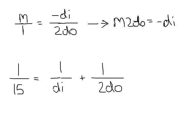

I tried to set it up like this:
1/15 = 1/di + 1/2do I don't know if that's even how it's set up or I tried to set up the magnification equation like
this: m = -di / 2do and cross multiply to get m2do = /di. I don't know how to set the problem up properly.
Hello Taco, welcome to PF :welcome:
You surprise me writing 1/f = 1/di + 1/do on one line and then 1/15 = 1/di + 1/2do a little further. Where does the 2 come from ?
If that is the magnification, then why first m = -di/do and a little further m = -di / 2do ?

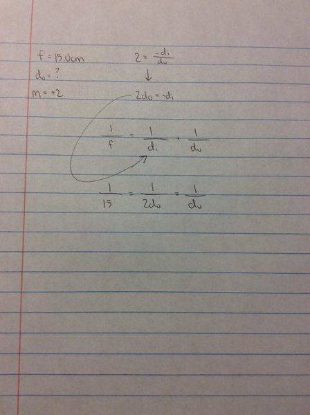

The real lens equation is similar. I have a screen shot of magnification and tin lens equation. My teacher said we can use di/do and hi/ho since its easier. I don't really know if the negative sign in di matters but I know it means virtual image and on the same side as the object, so yes, you are right about it being upright. Also the question says the image has a magnification of +2. Here is what i have done so far with what we've discussed
OK, textbook page is clear on what they mean (and you reproduced that correctly in your original post).
Your notes leave something to be desired, though: M > 0 leads us to expect one of the two of p and q to be negative. Let it be q (di).
So you have ##\ 2 = {-d_i\over d_o} \Rightarrow -d_i = 2 d_o## . Now for the lens formula: If I substitute ##\ d_i = - 2 d_o \ ## I sure don't get what you get !

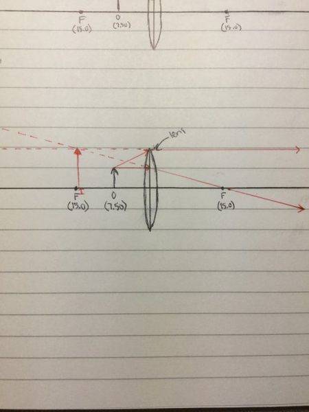

In the mean time I've made a drawing and the situation is completetly clear ! I invite you to do so too, it really helps understandding, also for later exercises.

Thank you BvG! I wouldn't have solved it without your help. The answer is 7.50cm and the book answer is also 7.50cm. I've made a red pen mark in what you've got that I also missed.

That looks very good! Up to you to make a drawing. It's really useful to develop that skill, it'll help you a lot in other exercises.
Oh yeah, I forgot about that, I think this is right but it's not drawn to scale.
Likes BvU
You've made my day and made me proud !
Not to scale is not relevant. You used the proper phsyical principles
  1. rays going through focal point come out parallel to the optical axis
  2. rays coming in parallel go through focal point
  3. rays going through center go through unaffected
A (perhaps) dashed line from foot of red arrow to tip of black would heve made it even clearer, but it's obvious that you understand it all.
And you still have one of the three rules left over for checking purposes !
Likes gracy
Hey, glad I made your day as you did to me too! :) Yeah, the 3rd line going through the center is good but probably will use it on the test. Glad it's solved, cya around BvU!

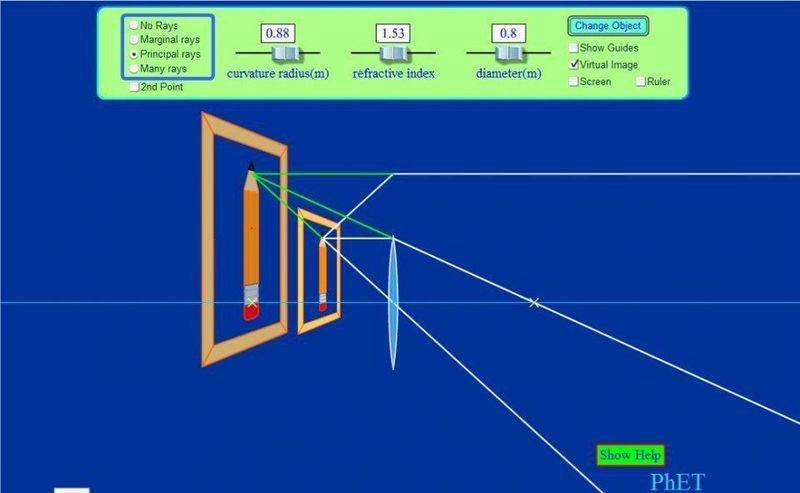

JaredMTg found a place where you can play with a lot of physics simulations, also with lenses !
You can ask for the virtual image and shift the object to get a picture like

Hey, thank you again! I will definitely try it out to prepare me for the exam.
