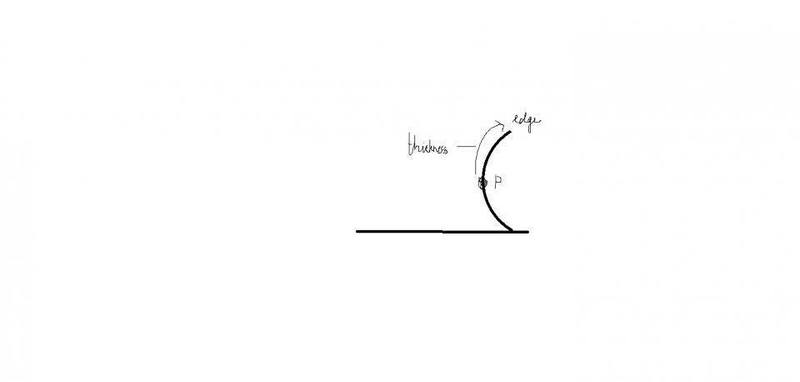

so, the longer the distance between the pole of mirror and its edge, the thinner the mirror would be, right?
is this the thickness you're suggesting? or not
I was suggesting that the "thickness" is the horizontal distance from p to edge (referring to your drawing).
Do you mean 'thinner' in terms of the ratio of the radius to the depth?

so, the question in my exam was to modify a convex mirror in some aspects ( including the thickness) so that it can be used as an anti-theft mirror efficiently.
to be honest, i don't know what 'thickness' the question was referring to, since my syllabus for physics is very basic, I'm assuming that the thickness refers to the distance of mirror's vertex and its back
so, i can't see why a thin mirror would do a better job (from the answer given)
so, i come here to ask if the 'thickness' of mirror refers to something else
i hope you understand my question :)
OK. That's a concrete question. I would say that the answer is that, for a given width, the thickness (focal length) should be chosen so that the field of view is the right width for the shop.
