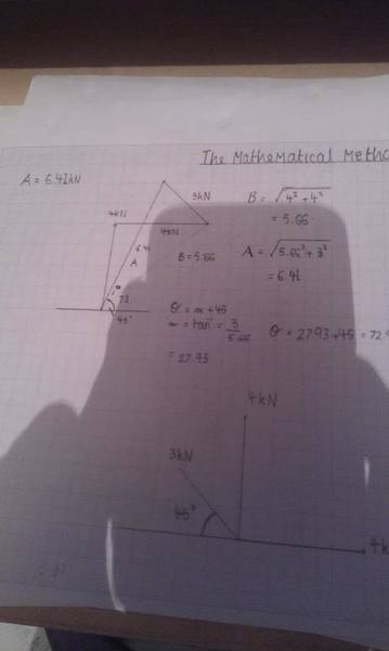

the example i did was with 3 vectors and i joined the end of the 3'rd to the beginning and measured and got my answer if that makes sense

the start point mate (4kN vertical, 4kN horizontal then 3kN at 45 degrees from that, then joined the end of that to the very start of the vertical)
JollyJed said:
the resultant mate.. to do it graphically you have to draw another line and measure it don't you?
Yes, find the resultant of the vertical and horizontal vectors and (vectorially) add this to the 3kN force at 45 degrees. In this case, it is probably easier to do a proper scale drawing and simply measure the magnitude of the resultant and it's angle from +ve x. You could also use various trig techniques (such as sine/cosine rules).
EDIT: did you notice your vectors have changed from having magnitudes 8 and 6 to 4 and 4?

thats what i have to do mate, i have to work out using a scaled drawing and using trig, and the vectors 4,4,3 was the one i did at college.. the one I am struggling with at the moment is the 8 and 6 :/
i have drawn the lines on graph paper but have no idea how to get the resultant from it..

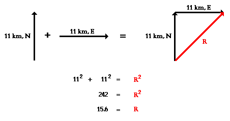

my scenario look like this picture
but with one vector 6kN and one 8kN , would my resultant be the red line?
Yes.

what do i do after 6(2)+8(2) = 100?
do i square root it?
JollyJed said:
thanks mate :) that's what i thought but didn't seem right..
Yes, but do you know why?
i don't mate.. care to enlighten me?
You have two vectors that are perpendicular and when you add them together you get a vector going from tail of one to the head of another. You can now think of this as a vector triangle. If the resultant you think of as the hypotenuse of a right angled triangle, you would use Pythagoras to find the length.
Remember your intial problem is a special case (the vectors being orthogonal). You can't always use Pythagoras to find the length.

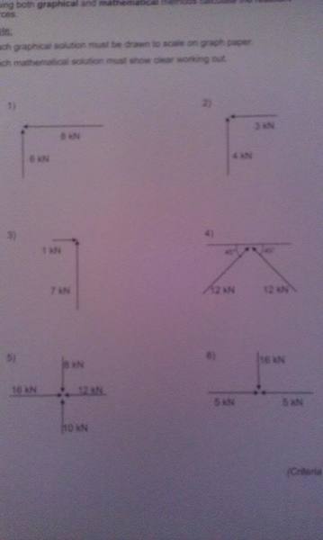

how would i work out this one
its a horizontal line with a 45 degree vector going left and a 45 degree vector going right?
I can't make much sense of that. Can you post a picture?
number 4 mate
At this point you have to provide an attempt (forum rules) before I can help. What have you learned in the previous problem that can be applied here?
Well i would draw the first 12kN 45 degree vector, then on top of that i will do the other one, and draw a line from the start to the tip of the 2nd vector - then i would measure that line..
to do it mathematically I am not sure.. as i can't use trig? 12(2)+12(2) and square it?

inclined at an angle, so looks like half a kite like
and no as there's 45 degree angles and not a 90
Also, in your last example, since force is a vector you necessarily have to specify a direction associated with it. Did you get this? You can do this most easily with a protractor.
yeah so both lines need to be at a 45degree angle?

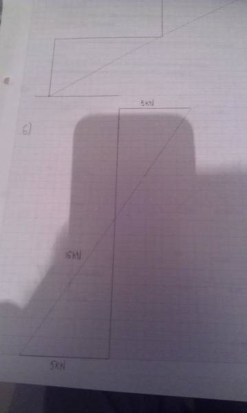

could someone help me with 6 please?
5kN + (-5KN) = 0
Remember to add vectors you add head to tail. You're left with just the vertical force.

but there's also 16kn mate?
Correct, so that's the force your left over with. Nothing else can be done.

and why is 5kn + 5kn 0? it should be 10 surely?
  • #32
Well..think of it like this:
If you push against your friend with 70N and he pushes back with 70N, then neither of you will move, so there will be no movement along your X axis (Your force vectors into each other cancel out), but then I can come along perpendicular to you guys (on the Y axis) and push you over with 30N of force, and no force will be back at me (in a very simplified situation, neglecting all other forces) So I'll have a east time doing it. Does that make sense? So the only vector which causes movement in this case would be MY 30N along the Y axis.
  • #33
Yeah i understand mate, but how would you do the working out using the 5,5 and 16kN?
  • #34
Consider first the two 5kN forces. Add these head to tail. What do you get?
You don't have to consider those two forces first, it just simplifies things.
  • #35
0kN?
