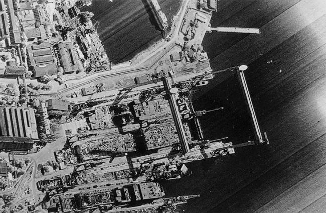

This is from about 200 miles up from a KH-11 era bird (Hubble quality optics). Not even close to a nickel, maybe 5 to 9 inches after processing several view frames from the raw data. The person who released these spend time in jail.

But your premise is wrong, so the question makes no sense, not even in the hypothetical. If you want to know what spy satellites can resolve on the ground, make your calculations using the correct orbital height.

This is from about 200 miles up from a KH-11 era bird (Hubble quality optics). Not even close to a nickel, maybe 5 to 9 inches after processing several view frames from the raw data. The person who released these spend 16 years in jail.
