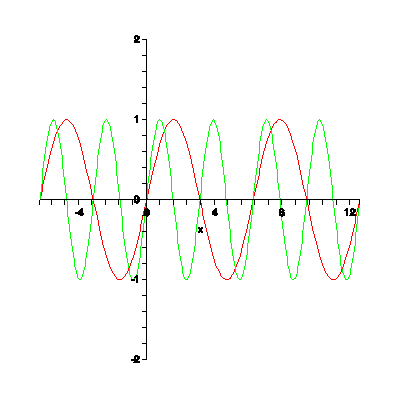

What I mean is that if you know the signal is bandlimited to B Hz, and you sample at frequency f_s=2B, if someone send you a sine wave x(t)=sin(2*pi*B*t), and you sample at t=0,1/(2B),2/(2B),3/(2B),4/(2B),...,n/(2B),... then you will be very unlucky and getting all zeros, which you probably will think there is no signal at all and you can have no way to reconstruct the original sinusoidal signal... thus violating the Sampling Theorem which garantee you can reconstruct the original signal.
That is incorrect. I thought you were eluding to the fact that Nyquist need not apply in all situations. Here, plot sin(x) and sin(2x) you'll see these two functions cross at multiple points--enough to reconstruct a wave.
chingkui said:
The Sampling Theorem states that when you have a signal x(t) bandlimited to B Hz, then if you sample the signal at frequency f_s higher than or equal to 2B, then you can use the sample to reconstruct the original signal x(t) uniquely.
no, the sampling theorem says that you must sample at a rate (f_s) strictly greater than 2B. f_s = 2B is not good enough (there are an infinite number of sinusoids at frequency B that alias to the same set of samples.
Yet, if you consider the simple sinusoidal signal x(t)=sin(2*pi*B*t),
yeah, that's a bummer. f_s must be bigger than 2B.
