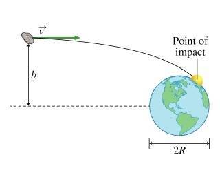

In this problem, you will estimate the cross section for an earth-asteroid collision. In all that follows, assume that the Earth is fixed in space and that the radius of the asteroid is much less than the radius R of the earth. The mass of the Earth is M_e, and the mass of the asteroid is m. Use G for the universal gravitational constant. View Figure
There is a height b that can be seen in this picture:
http://phazei.8m.com/ext/phys.jpg
For large earth-asteroid separation, what is the magnitude of the asteroid's total angular momentum L_initial about the center of the earth?
L_initial =m*b*v
The maximum impact parameter for which collision is guaranteed, b=b_{\rm max}, is obtained by setting the minimum earth-asteroid separation equal to the radius R of the earth. This is the configuration shown in the figure. In this case, it is clear that the velocity of the asteroid right before it hits the Earth is tangent to the surface and therefore perpendicular to the position vector that points from the center of the Earth to the asteroid.
When b=b_max, what is the total energy E_surface of the asteroid the instant before it crashes into the earth? Assume that the speed of the asteroid at closest approach is v_f.
E_surface =(1/2)*m*v_f^2-G*m*M_e/R

I was able to get all the with a bit of work, but this next part I am stumped on.
Use conservation of energy and angular momentum to find an expression for (b_max)^2.
I found m*b_max*v=m*R*v_f, I solved for v_f and put it into the E_surface equation and solved for b_max^2= 2*G*M_e*R/v^2
but apparently that's wrong :(
What's wrong with it?

There are quatity is conserved in your problem: Energy and Angular momentum...
But I didn't see you use the conservation of Angular momentum in this problem...
apply the conservation of angular momentum and the rest is simple algebra,,,,
"I found m*b_max*v=m*R*v_f, I solved for v_f and put it into the E_surface equation and solved for b_max^2= 2*G*M_e*R/v^2"
mrv... isn't this the conservation part of it?
m*b_max*v = m*R*v_f
the initial and final angular momentum...
sorry, I miss that one...
2*G*M_e*R/v^2 should be your answer unless you made some algebra mistake..
what make you think you did it wrong?
I submitted the problem and it said it was wrong... :(
Express your answer in terms of m, M_e, R, v_f, and G.
is it a typo or what? I don't think you should express the answer in term of v_f since it is not one of the known quatity...
if this is not a typo, do what the question asked..
My friend, you didn't apply conservation of energy...
E_surface = (1/2)*m*v_f^2-G*m*M_e/R
E_initial = 1/2 mv^2
set them equal...
L_initial = mbv
L_final = mRv_f
set them equal again...
and do the algebra
