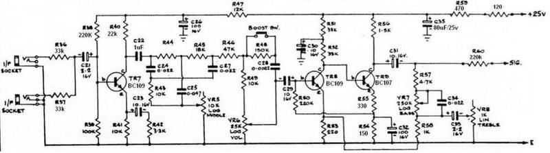

Hello erer44
Could you please post a schematic of your circuit, so that we can get a better idea of what is going on. It would also be very helpful to know the input signal, and output load (if any).
Of course. This is the preamplifier section I am working out the kinks on right now. I'm putting 1.5vP into it from the function generator, and it goes through a power amp and output transformer for 8 or 16 ohm speaker loads.
Thanks again! Let me know if there's anything you can't make out.

Why don't you put 1 millivolt peak into it and see what you get? 1.5 volts peak input seems a bit much. Make sure you are getting less than 1 volt peak out (TR9 collector). Also, measure the dc steady state voltages of all transistors, and compare them to the schematic.
Bob S
That did it, thanks! Now I can get to building the real thing.
