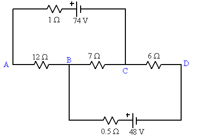

AB, BC and CD are three resistors connected together at B and C. AB = 12 ohms, BC = 7 ohms, CD = 6 ohms. A battery of emf 48V and internal resistance 0.5 ohms has it positive pole connected to B and its negative connected to D. A battery of emf 74V and internal resistance 1 ohm has its positive pole connected to A and its negative pole connected to C. Find the current flowing in BC.

I'm not sure of your circuit. Whnat does "connected together at B and C mean?
I am not exactly sure either, I've just copied word for word the question my professor has given.
You should be able to draw the schematic with two current loops. Using Kirchoff's law, you can have two equations with two currents. Solve them simultaneously.

Then tell your professor that he has not provided enough information for there to be a solution.
An interpretation that seems to fit the bill:
I think that there are 3 resistors in series. There are 4 terminals. 12 ohms between a and B, 7 ohms between B and C and 6 ohms between C and D. 48 volt battery with .5 ohm internal resistance connected with + to B and - to D.
Using gneil's diagram I'd just split it into 2 loops and then as 'barryj' suggested, solve them simultaneously.
