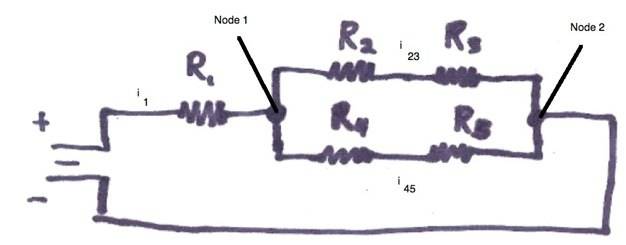

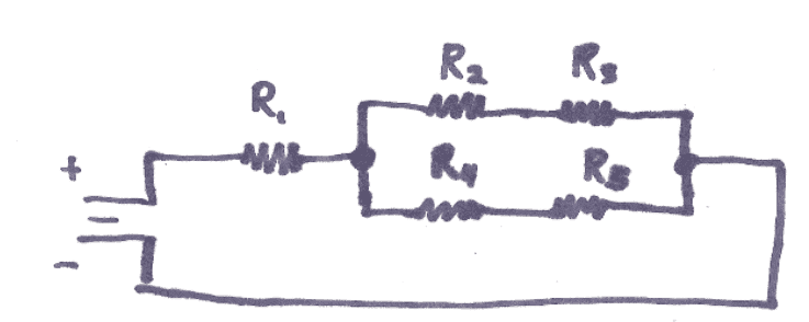

How can I find the current through R4 if the source voltage is known?
In summary: It's a little more complicated than that, but that's the general idea.In summary, the problem is asking for the current through resistor 4 in a circuit where the source voltage is Vo. To find this, the equivalent resistance of the entire circuit must be calculated and then Ohm's law can be applied to determine the current through the parallel block of resistors. From there, the current through R4 can be found by using the fact that both R4 and R5 have the same current flowing through them. It is important to treat the circuit as a whole and understand that the voltage is divided and distributed across all the resistors, not just one.
Saladsamurai
3,020
Given that the souce voltage = Vo, find the Current at resistor 4.
For resistors in series, I = constant
For resistors in parallel V = constant
So I gather that since the block containing resistors 2-5 is in series with R1, then whatever current leaves R1 must enter that block as well.
So at R1 we have: V1 = Vo = I1*R1
so that the current leaving R1 and entering the block is I1 = Vo/R1
Now I need to find out how much of that current diverges into R4. Here is what I am thinking:
The amount of current entering R2 and R4 is weighted by one of two things, either the values of R2 and R4 OR the values of (R2 + R3) and (R4 +R5), that is the total resistances in each 'leg' of the block.
I think it is the latter, but I am hoping someone can confirm.
Any thoughts?

What you need to find is the current through R4. Start by combining resistors to find the equivalent resistance. Then apply Ohms law.

1.)OK, so I know that Io enters the 4-resistor loop. Let's call the equivalent resistor of that loop R25. Now I can find the Voltage drop across the equivalent resistor as
V25=IoR25. Okay then!
2.)Now I take R25 and break it back up into two parallel resistors (each of which is a sum of 2 resistors in series) that we will call R23 and R45.
So since these two resistors are in parallel, I believe I can say that each one of them takes half of V25 right?
3.)Use Ohm's law to find the current through each of R23 and R45 that we shall denote I23 and I45.
4.)Since R45 is comprised of 2 resistors in series, then R4 and R5 both have current of I45 running through them.
Any flaws in my logic here? Wouldn't be surprised!

Look at the loop with resistors 2 through 5. I take R2 and R3 and create an equivalent R23; I do the same for R4 and R5 to crate R45. Now R23 and R45 are in parallel.
Please point out where I am wrong:
1.)Since R23 and R45 are in parallel they must have identical voltage drops across them.
2.)If I combine R23 and R45 into an equivalent resistor R25, then the voltage drop across R25 = R23 + R45.
According to what you have said OmCheeto, the latter is incorrect. But I also though that the drops across R23 and R45 had to sum to the drop across R25 (i.e. the sum around the loop). So I am screwing up somewhere.

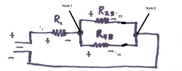

According to Gustav Kirchhoff, the voltage around a closed loop must be equal to zero.
To see what he was talking about, let's add polarity signs to your equivalent resistors.
Starting at node 1 traveling to R23, we see that we'll drop a voltage +V23. Continuing on through node 2 and through R45 we see a voltage drop of -V45. According to Kirchhoff, V23 added to V45 must equal zero. And the only way this can happen is if they are equal in magnitude.
Hey OmCheeto. Ok, I see that but that still does not tell me why when I find R25 = (1/R23 +1/R45)-1 and the voltage drop V25 why V25 should be equal to V23 and V45.
But, you have me thinking now that if I apply Kirchoff's Rule to the new circuit that contains only R1 and R25 something may reveal itself to me. Not sure though.

So you understand that an equivalent resistance with two resistors is in series with each other must really have the same current flowing through the two resistors, but you are having trouble understanding why two resistors in parallel have the same voltage dropped across them?
The previous reply is probably the best mathematical way to show why the voltage drop across each resistor in parallel with the other must be the same. You can also kind of "think" your way into an understanding of why it must be. If two resistors are in parallel, they are "seen" by the battery as one equivalent resistance, so the voltage dropped across the two parallel resistors is the same because the battery "sees" a resistance and simply drops a voltage across it. It happens to be two in parallel so the drop across both of them is the same, but the battery knows not that there are two resistors it is dropping some of its potential across, it simply "sees" a resistance and drops some voltage across it; since they are connected to each other on both ends, then the drop across the two of them must be the same.
The equivalent resistance of two resistors in parallel, say R1 and R2, can be found by 1/[(1/R1) + (1/R2)] which is also equal to simply R1R2/(R1 + R2). Once you have your equivalent resistance, you can use Ohms law for a circuit with two series resistor in it, those being the equivalent resistance of the parallel combination of the two series resistor sets, and the other resistor in series with that equivalent resistance is just R1.
Find the voltage dropped across the equivalent resistance and divide it by the series combination of R4 with R5 to find the current that flows through the two series resistors, as it will be the same. You just need to figure out how to properly combine R2 with R3, and R4 with R5, and then what the parallel combination of those two sums are to find the equivalent resistance.
Ohms law should help you from there by simply looking at the "new" circuit as two resistors in series, one being R1 with the equivalent resistance RE made from combing R2, R3, R4, and R5 in the correct manner to get the correct equivalent resistance.
If you can get that far, finding the voltage dropped across the equivalent resistance should be straight forward using Ohm's Law. Just remember that the voltage dropped across the equivalent resistance by combining R2, R3, R4, and R5 in the correct manner, is dropped really across both R2 + R3, which is the same drop as that across R4 + R5, so when you find the voltage, ask yourself, what is this voltage being dropped across in resistance such that you can find the current you are looking for.
If you simply find the voltage dropped across the equivalent resistance and divide it by that resistance you'll get the current that flows into both "legs" of the parallel combination of the resistors that are in series with each other, or in other words the current that is actually leaving the battery and some of it when it hits the node that splits into two different paths with two resistors in series in each path, will go down one path while the remaining current from the battery will go through the other path, exit from both "legs" and recombine to the full current that is coming from the battery.
Hope this helps.
