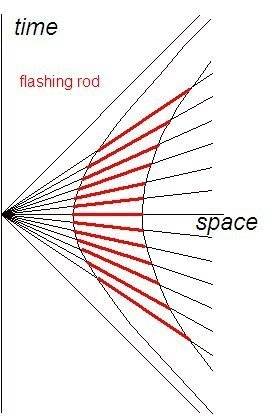

Hi all,
The attached diagram represents a lab undergoing proper born rigid acceleration in a straight line relative to an inertial observer, drawn on a Minkowski diagram.
Imagine the lab to be multi storey, with observer on each floor with their own clocks. In the diagram two observers on different floors send timing light signals (the blue lines) to each other (Events A and B). They receive these signals simultaneously at events C and D because both these events lie on a line of simultaneity in the lab (The magenta lines). On receiving these signals they echo them back and the signals arrive back at there respective observers simultaneously at events E and F.
Within the accelerating lab, observers spatially separated (horizontally and vertically) observe that once their clocks are synchronised, they remain synchronised so they consider their clocks to run at the same rate. This can not be said for clocks at the top and bottom of a tower on Earth for example. This is because spacetime on Earth is curved while spacetime measured by observers in the accelerating lab is flat. The spacetime within the lab is flat because all spatially separated observers consider their spatial separation to remain constant and their clock rates to remain constant with respect to each other. Despite the apparent flatness of the spacetime they occupy, the observers in the lab observe light moving horizontally to follow a curved path, and any dropped objects to accelerate downwards. Hence you have "gravitation" in flat spacetime.
In an earlier discussion with Jennifer we mentioned that a cylindrical hypersuface can be considered flat in GR while a spherical hypersurface is curved. I made the analogy that the surface of a cylinder is curved in one spatial direction (single curvature) while the surface of a sphere is curved in two spatial directions. (Double curvature). Likewise the accelerating lab can simulate the single curvature of the cylindrical surface but it cannot simulate the double curvature of the spherical surface. Special Relativity, Minkowski diagrams and Rindler spacetime can handle the flat spacetime (single curvature) of an accelerating lab while general Relativity is required to describe motion in the spherical gravitational topology (double curvature) of a typical spherical massive body.
In the Minkowski diagram it is easy to observe that the proper acceleration measured by different observers on different floors of he accelerating lab is proportional to 1/R while the proper acceleration measured by observers in a tower on the Earth varies as 1/R^2.
This is another difference between the flat spacetime of the accelerating lab and the curved spacetime of a spherical massive body.
Free falling observers in the accelerating lab observe light rays in any direction to follow straight paths (straight null geodesics), while the non inertial observers at rest with the lab frame observe light rays to follow curved paths (curved null geodesics).
On the other hand, observers in a lab free falling towards the Earth will not observe light rays to follow exactly straight paths unless the lab is very small and then the paths will approximate straight lines. These free falling observers will not consider their spatial separation to remain constant and they will not consider their clocks to run at the same rate. This is because the curved spacetime with the lab free falling towards the Earth is not the same as the flat spacetime observed by observers freefalling within a lab that is being accelerated by a rocket.
Nearly every reference to a "null geodesic" in a google search suggest a null geodesic is a path and not a point.
Having, thought it through (and rejecting the conclusions I made in post #4 which were only true for an infinitesimal region of space) I tend to think the views and definitions expressed by Pete and Dalespam are the correct ones in this thread.
Admittedly the term "flat spacetime" is a confusing definition for the spacetime found in an accelerating lab, but that seems to be the definition most widely used in texts on the subject. I think that is to differentiate it from the curved spacetime measured in the proximity of a large gravitational body that can not be duplicated by an linearly accelerating rocket except in an infinitesimal region of the gravitational body.
Also as alluded to earlier, it seems that flat spacetime has the property ( possibly a definition?) that all observers at rest with that spacetime and maintaining constant spatial separation measure their clock rates to be the same irrespective of the fact that they may feel or measure different proper accelerations to maintain that constant spatial separation.

  • #46
Hi Kev. I think you have these two parts slightly wrong. The Born-accelerated observers on your 'floors' do not agree that their respective clock rates are the same, because their clocks get more and more out of sync during the acceleration. Think what will happen in your Rindler diagram when the acceleration is stopped - don't you think the clocks will then need to be resynchronized?
Your purple lines of "instantaneous simultaneity" is when the clocks on all floors read the same time, but they realize that the clocks get out of sync. Light signals send forward and backward during the acceleration are red-shifted and blue-shifted respectively, just like in a gravitational field. It's only the tidal effects that differ, AFAIK.

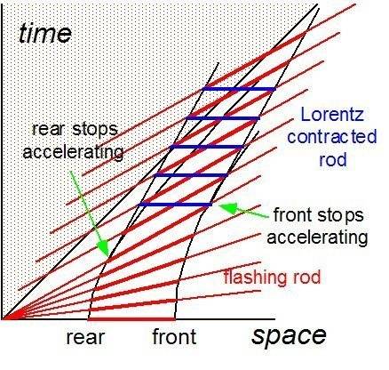

The above relation holds in the accelerating rocket frame. A signal leaving A at Ta = 1 second arrives at B at time Tb = 2 seconds and returns to A at time Ta' = 3 seconds, then Tb - Ta = Ta' - Tb = 2-1 = 3-2 = 1 showing the clocks are synchronised according to Einstein's definition. We can further check that a signal leaving A at Ta = 3 seconds arrives at B at time Tb = 4 seconds and returns to A at time Ta' = 5 seconds, then Tb - Ta = Ta' - Tb = 4-3 = 5-4 =1.
Condition 1 in the list states that A and B agree at all times on matters of simultaneity. This suggests that they agree their clocks advance simultaneously.
We can also add a third inertial observer C and note the following:
1) A and B agree at all times on matters of simultaneity.
1) If A and B agree that two events are simultaneous then C does not agree those events are simultaneous.
2) A and B agree at all times on their common velocity.
2) C does not agree that their velocities are equal at any given instant.
3) A and B agree that their separation is constant.
3) C does not agree that the separation of A and B is constant.
4) A and B agree that B’s clock runs faster in direct proportion to their respective vertex distances.
4) C agreee that B’s clock runs faster in direct proportion to their respective vertex distances.
Odd that C disagrees with all measurements that A and B make except for item (4). It seams the measurements of A and B should be swapped with those of C for item 4 to make a consistent list of observations.
On page 13 of the presentation you linked to, the author does agree that flashing clocks at positions A and B will be flashing simultaneously. That contradicts item 4 of the list.
  • #69
Hi kev, I don't quite follow your logic with the extended list that you supplied and how it contradicts Mallinckrodt. Can you explain a little more?
Slide 13 of Mallinckrodt seems to hold that "flashing synchronously is not the same as flashing at a definite time interval because the clocks run at different rates". So how does that contradict the different clock rates?
I must confess that Rindler frames are quite slippery on some of these concepts and it is always possible that even the professor did slip up! I'll give it another thought in the next few days. Maybe the moderators can help us out?
-J
  • #70
Hi again kev. I understood what Mallinckrodt wrote as: the rod flashes at the same clock times all along the rod, but for rear- and front end observers the intervals between the flashes are different. It should be like that if the proper length remains the same for those observers, yet they experience different proper accelerations. The front clock records less acceleration because it runs faster than the rear clock. How else?
-J
