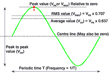

Thank you all. Yes, I am interested on the peaks. Another consideration of mine is how the Chainring is configure: For example, a ring connected to a 104 BCD Spyder have a different approach on the numbers needed to find these forces. A direct mount ring (Spyderless) is one single part, and the diameter of the Slot attachment would also need to be considered...(I'm thinking) .
Merlin3189, Quick last check: I've started using 1273N as my resulting number for my experiment...but after reading your message again, for some reason got me confused.
'My opinion is that the force varies roughly as a sine function. If the rider is applying a vertical force on the pedals, then the torque is zero at the top and bottom of a pedal stroke, reaching maximum half way between, when the crank is horizontal.
Using this model, the average torque is about two thirds of the peak torque (average magnitude of a sine function = 2 x peak / π)
And the peak tension in the chain is 1273 x π / 2 = 2000 N (Equivalent to 200kg weight)'...
Should I just use 1273N as my peak force concerning material strength, or 2000N? I'm a little confused on this 2000N value.
2000N is the peak value. 2/3 (or really 2/π) of that is the average value 1273
See diagram
My interpretation was that 1273N was found using a constant torque applied to the pedal (at 1000 Watts/100 rpm). Since I'm assigning 1000 Watts/100rpm in my question as the Maximum Power Output (not an average), this 'average' of 1273N on the chain would actually be at Peak...Thinking like if we replace the rider by a motor running at 1000 watts/100rpm.
I just realized that I didn't specified on my first question that these numbers were a Peak...not Average...I apologize for that.
Yes, that's fair enough. If the peak power is 1kW, the peak torque is 1273N.
