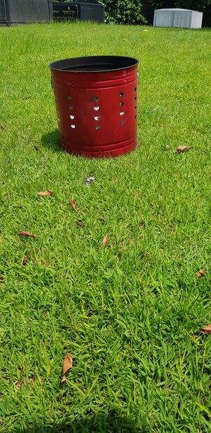

This is the color of the metal bucket when it's not hot. But whenever it is hot, the red changes to dark, and then back to red again when it is not hot. See the following youtube where I just threw the fake money at the bucket (see background below). Can you explain how the phenomenon work? Maybe related to Blackbody Radiation or something?
In the bucket, I'm burning fake money at the cemetery which our family does a few times a year. In this particular time, it's middle of so called Ghost month. The Chinese tradition believes that during certain period in a year, there is loosening of barrier between our world and the dark world (although they didn't say dark matter world).
Of course, we Newtonians can just scoff at the idea, we can prove with our nut and bolts machine that there is no dark world or something.
Looks like thermochromism of the coating of the bucket, but I couldn't say exactly what's happening at the molecular level or anything.

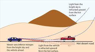

Drakkith said:
Nope. Any such effect would severely distort the image of the bucket, which isn't seen.
Light is normally scattered at the incidence angles but in a mirage it is bent like in this image so if you were looking from above you might see less incident light being reflected and perhaps notice a slightly dimmed surface. For the bucket if the hot spot refracts incident light along the bucket surface then an outside observer might see a dark spot.
There's no reason for a dark spot to appear, as light from somewhere else would be deflected into your eye and you would see a distorted image of whatever object that light came from.

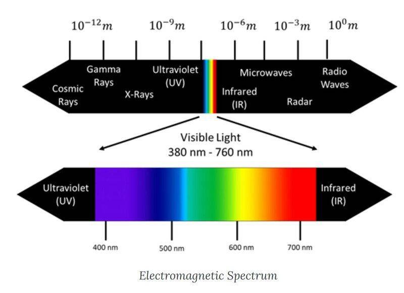

When thermochromic paint got heated and become invisible. What part of the spectrum is it hiding? In the infrared maybe?
Why are there no natural physical objects that only exist in the infrared or other frequencies and hence invisible to the naked eye? Or since I remember infrared is heat. Why do objects only occur in visible wavelength?
You mean like glass ?
There are plenty of objects that are transparent to visible light. Glass, some types of plastic, wings of insects, water, air, etc. Similarly, there are objects that are transparent in infrared but not in visible light, such as plastic trash bags.
