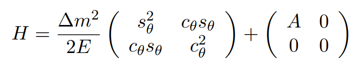

Ah. How do I find by propagation eigenstates then? I'm assuming it'd be just the eigenstates of my Earth-propagation Hamiltonian? So I need to diagonalize my full Hamiltonian. But I'm not sure how to relate that to ##\nu_e## or ##\nu_1##. As in, I took my Hamiltonian (which for this case is
where ##A = \sqrt{2} G_F N_e##. So I found the eigenvalues and eigenvectors of this Hamiltonian but I'm not sure how to tie that back to the mass / flavor eigenstates.

What you have written down is the Hamiltonian in flavor basis. In the mass basis it would look different.
Okay, does that mean the eigenstates of this Hamiltonian (which is in flavor basis) would relate to the flavor eigenstates? Or do I have to convert this in the mass basis, find its eigenstates, relate that to mass eigenstates? If my first statement is true, how does the eigenstates of my Hamiltonian relate to the flavor eigenstates?
If you write the Hamiltonian in flavor basis, then the flavor eigenstates are represented by ##\begin{pmatrix}1 \\ 0\end{pmatrix}## and ##\begin{pmatrix}0 \\ 1\end{pmatrix}##.
Right. But you said the Hamiltonian I wrote is in flavor basis so wouldn't that imply that its eigenstates are flavor states? Then, it'd be the flavor states that would propagate but that's incorrect like you pointed out in post #2.
No. The Hamiltonian is the Hamiltonian whatever basis you write it in. If the flavor states were the eigenstates of the Hamiltonian and the Hamiltonian was written in flavor basis, then it would be diagonal.
