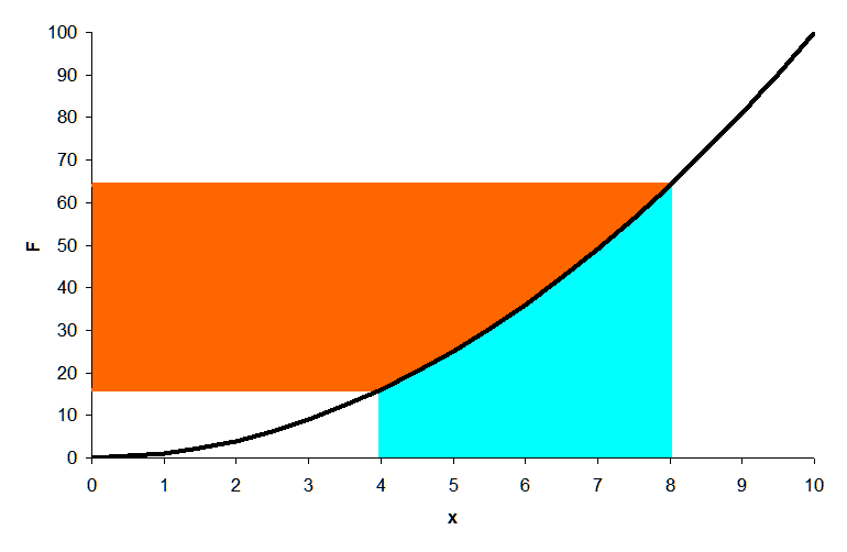

Here is a graphical representation of ##F=x^2## (black line):
The blue area represents the integral:
$$\int_4^8 Fdx$$
The orange area represents the integral:
$$\int_{16}^{64} xdF$$
This should help you visualize how different can be ##Fdx## and ##xdF##.
Why nobody uses ##xdF##? Because ##x## is a position that is dependent on how you define the frame of reference, so it is rather useless. But the difference between two positions (##dx##) is the same no matter what is the frame of reference.
For example, say you want to know the distance between 2 points (imagine 2 cities on a map). One point has the position (0) and the other one (10). The distance is is 10 - 0 = 10. But if we change the system of reference where the origin is somewhere else, the first point may hold the position (32) and the other one (42). The distance is still 10 (= 42 - 32).
In such a case evaluating something based on the position would be meaningless as it would change depending on your frame of reference.
But there are cases where you can have meaning for both integrals. In thermodynamics, on a Pressure-Volume diagram, you can evaluate ##Vdp## or ##pdV## to evaluate the work done. The ##pdV## form is called boundary work and relates to a closed system, like when a fluid is enclosed within a chamber that can vary in volume (piston-cylinder arrangement), but the mass inside stay constant. The ##Vdp## form is called isentropic shaft work and relates to open systems where fluid comes in and out like with a turbine. In that case the physical volume of the turbine doesn't change, but the output pressure is different from the input pressure. ##Vdp## considers the ##pdV## part, but also the work needed to maintain the flow within the system.
