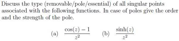

Singularities and Analyticity at z=0
In summary: You know how to expand cos(z) and sinh(z) in a power series around z=0. Put those expansions into the two functions and simplify. See what you think. Then look back at the definitions.
Ted123
446
Both [itex]\displaystyle \frac{\cos(z)-1}{z^2}[/itex] and [itex]\displaystyle \frac{\sinh(z)}{z^2}[/itex] have 1 singular point at [itex]z=0[/itex].

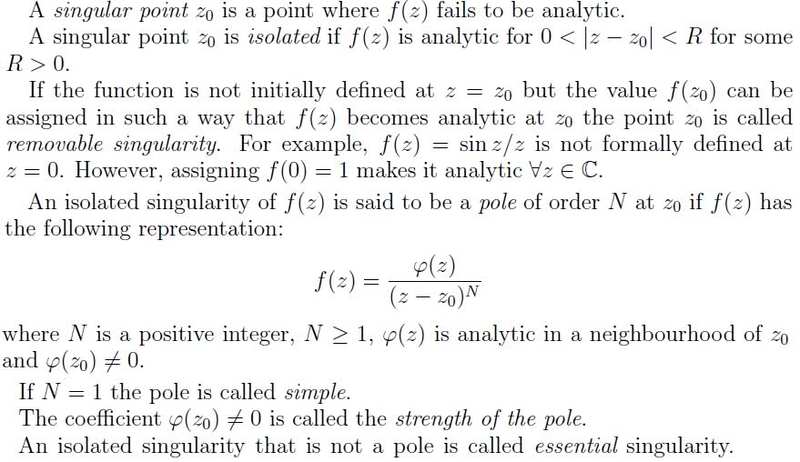

Probably because I'm not understanding the definitions correctly!
These are my set of definitions:
I think for both (a) and (b), z=0 is an isolated singularity but not a pole, so an essential singularity. But they probably aren't removable.
The definitions will be clearer to you if you look at a power series expansion of each function around z=0.

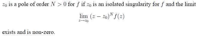

I don't like how some of these definitions are given so if I use this definition of pole:
Clearly [itex]z_0=0[/itex] is an isolated singularity since it is the only singularity for both (a) and (b).
(a) [itex]\displaystyle \lim_{z\to 0} \;(z-0)^N f(z) = \lim_{z\to 0} \; z^{N-2} (\cos(z)-1) = 0 \;\; \forall \;N>0[/itex] so [itex]z_0=0[/itex] is not a pole. Hence it is an essential singularity.
(b) If N=1 then [itex]\displaystyle \lim_{z\to 0} \;(z-0) f(z) = \lim_{z\to 0} \frac{\sinh(z)}{z} = 1 \neq 0[/itex] so [itex]z_0=0[/tex] is a simple pole (of order 1). What would be the strength of the pole? It is not an essential singularity.
