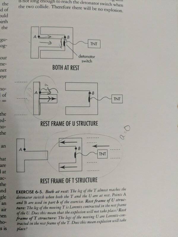

This is Taylor and Wheeler's problem 6-5, but reconsidered in a different form.
In Taylor and Wheeler, problem 6-5 "Detonator Paradox," a T-shaped plunger is not long enough to strike a detonator inside a U-shaped container. However, if the T-shaped plunger is moving relativistically, then in the reference frame of the T, the U shape is shorter and so the T is able to strike the detonator. The paradox is that in the U-shape reference frame, the T is too short to strike the detonator.
The answer in the back of the book says that the T does strike the detonator and explodes a bomb, even though this only happens in the T-reference frame.

I am not following the setup. A diagram would help a lot.
I just realized the solution -- in the laser version, there is no detonation because the two laser crossings are not simultaneous in the frame of the lasers.

If the T hits the bottom in one frame it hits the bottom in all frames.
I think that the general point being made here is that there may be a frame in which it is obvious that detonation happens or not, and since detonation or not is an invariant fact, you can assert that other frames' analyses must lead to detonation even if such analysis is complicated.
In Taylor and Wheeler's problem, the simple case is the T-piece rest frame. The first point of contact in that frame is the detonator, so boom. Careful analysis in other frames will show the same result (edit: by "result" here I mean the "boom", not the "first point of contact is the detonator"), but you have to worry about light cones and the implications thereof to show it.
Your laser device isn't properly specified because you haven't said what frame's simultaneity is used for the detonation condition. You do imply it's the lasers' frame in your next post, so I shall assume that. In this case, as you seem to have realized, the simple frame to analyse is the lasers' rest frame and there is clearly no boom. Careful analysis in other frames will show that your simultaneity detector doesn't function as a simultaneity detector in those frames, and whatever condition it does detect is never satisfied.

I'm sure the answer says that the bomb explodes. Full stop. Events don't "happen in reference frames". Events happen and each reference frame specifies the coordinates (time and space) of the event.
Likes Ibix
For the record, the exact words are "Yes, explosion. (Sorry!)"
