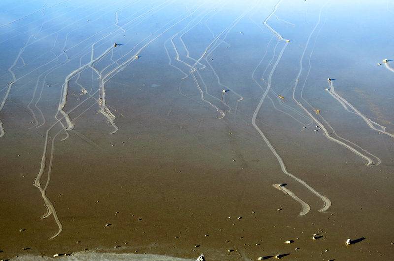

David Neves said:
When it rains, very small rivulets of water flow towards and pool around the base of the boulders. When the water evaporates, the ground contracts, leaving a very small dry creek bed leading to the boulder. This is what these apparent paths are.
One look at the patterns shows that your theory makes no sense:
Likes Evo
TurtleMeister said:
Or rather the wind causes the large sheets of ice to move and then the ice makes contact with the stones causing them to move also?
Right.
@David Neves:
  • The stones move. There is video evidence, there is GPS evidence, there is good old surveying evidence by comparing the position over time to reference markers.
  • The tracks are behind the direction of motion of the stones. If they would be from water flowing away, they should always be aligned with the slope of the terrain - they are not.
  • Tracks cross each other, something that cannot happen if they would formed by water flow.
  • Gullies would not have the width of the stone consistently over longer tracks.
  • Gullies would not have the material deposited at the sides that the tracks show.
You should be careful with accusations if you don't have the knowledge to back them, especially if your favorite hypothesis falls apart so easily.
