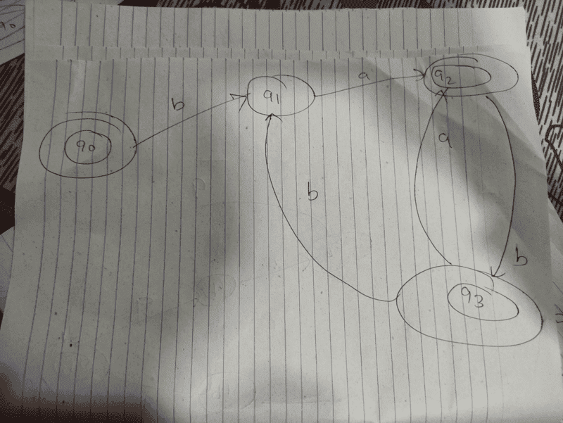

NDFA for (ba)* U (bab)*. Convert this to DFA.
none

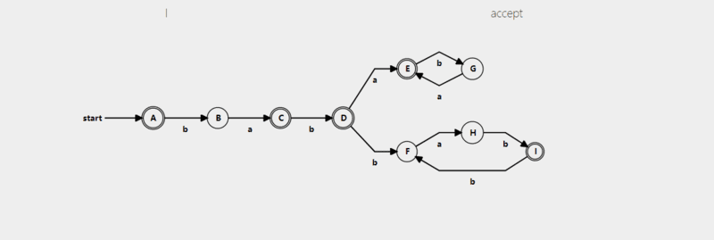

but the solution site says otherwise-:
https://cyberzhg.github.io/toolbox/nfa2dfa
I feel correct mine also, but not sure. Check it please.
Your DFA accepts is babba. But should it?
