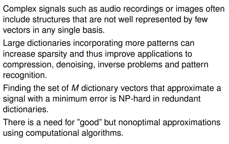

I found this at resource on frame and dictionaries at https://www.egr.msu.edu/~aviyente/ece802lecture9.pdf
In what sense are larger dictionary (overcomplete set of building vectors called atoms) more suitable for representing in a sparse way signals that have lots of structure?
Could anybody providing some clarifications? I am stuck with the idea of a complete basis as the best choice to represent an arbitrary signal...
Representing a signal using a frame, instead of a basis, leads us to several possible linear representations of the same signal which does not have a single unique representation. Apparently this is useful to create a simpler, more sparse representation of a signal...but why?
You are confusing the two parts of the notes you linked. The first part is about frames and ends with the summary on slide 9:
  • Frames are an overcomplete version of a basis set, and tight frames are an overcomplete version of an orthogonal basis set.
  • The frames and tight frames have a certain amount of redundancy. In some cases, redundancy is desirable giving a robustness to the representation. In other cases, redundancy is an inefficiency.
  • In finite dimensions, vectors can be removed from a frame to get a bases, but in infinite dimensions, that is not possible.
The second part starts with the slide you quoted and is about overcomplete dictionaries: these are not the same thing as frames.
A simple example of an overcomplete dictionary is a postal code: I am going to use the UK postcode system. We can represent the location of 10 Downing Street in eight characters using its postcode SW1A 2AA. This is more compact than using the orthoganal basis of latitude and longitude 51.5033N0.1277W.
