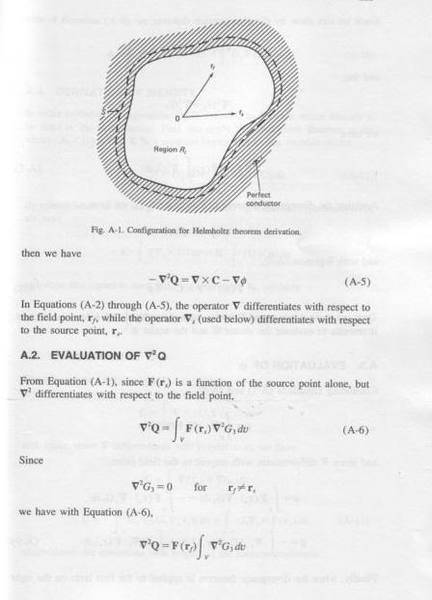

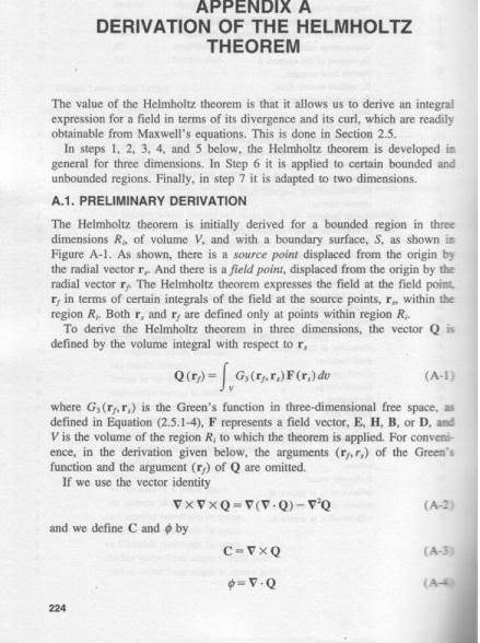

Hi All,
thanks for helping.. let me explain
i'm reading this text on the derivation of helmholtz theorem
let me just quote directly from the book
Page 2 top half
" In Equations (A-2) through (A-5), the operator 'del-f' differentiates with respect to field point rf, while the operator 'del-s' differentiates with repect to the source point rs"
May I know the difference between the operators here.
Page 2 bottom half
" From Equation (A-1) since F(rs) is a function of the source point alone, but "del-f" differentiates with respect to the field point... "
Well apparently we can move F(rs) out of the lapacian here. Please help explain how this is possible
thanks again

newbie101 said:
page 2 top half
That means that, for example,
[tex]\nabla_f V = \frac {\partial V}{\partial x_f} \hat {\bold i} + \frac {\partial V}{\partial y_f} \hat {\bold j} + \frac {\partial V}{\partial z_f} \hat {\bold k} [/tex]
whereas
[tex]\nabla_s V = \frac {\partial V}{\partial x_s} \hat {\bold i} + \frac {\partial V}{\partial y_s} \hat {\bold j} + \frac {\partial V}{\partial z_s} \hat {\bold k} [/tex]
where V is some function of [itex]x_f[/itex], [itex]y_f[/itex], [itex]z_f[/itex], [itex]x_s[/itex], [itex]y_s[/itex], and [itex]z_s[/itex] (that is, depends on both the field coordinates and the source coordiates).
jtbell,
So your vector V is analogous to the Green's function G(rs,rf) since it's a function of both rs and rf. But since F(rs) is a function only of rs, it doesn't vary with rf, so when derivatives are taken wrt rf, F acts like a constant.
newbie, does that help at all, or am I missing your point entirely?
jtbell & jdavel,
yes it does explain everything if vector V here is a function of both (x,y,z) at field point and (x,y,z) at source point... which should be the case
since the E field at a point would depend on both
1) where the field point is as well as
2) where the source is
however, I am still not understanding the partial derivative here ... i mean how is dV/dXf different from dV/dXs ... arent there only 3 axis here X,Y,Z so the gradient whould still be the same wouldn't it ?
newbie, When you say "the E field at a point would depend on...where the source is" it sounds like you think the source is located at a single point. That's not true here; the source is distributed over the entire volume.
Yes the source is distributed. Thanks jdavel
