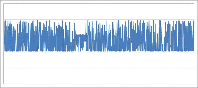

The more derivatives you take, the more sensitive the resulting value is to small variations in the original signal over small periods of time. i.e. to high frequency noise.
This figure shows some raw measurement data (the signal delay through a communications network). There is some sense in it somewhere (the expected signal delay), but how to find it in all the noise is a major headache.

Ok. So it is very ugly. But, still, if we zoom in then we would see a continuous and differentiable signal.
I mean. Pretend that the above graph is the movement of a point on a 1D axis. It moves very fast. It goes from a positive derivative to a negative derivative incredibely quickly. But still the derivative is not infinite at any point in that graph. Infinite derivative means infinite velocity which would mean infinite energy.
That graph as ugly as it looks it is still a physical signal which is continuous and differentiable.
You said "pretend". We can pretend that there is infinite energy. That's not a problem.
No. The data points are measurements of the signal delay through a communication network. The measurements are discrete. The measurement noise is due to delays both in the end nodes and through the network.
I'm not talking about measurements, about digital signals. I see that I said above something about digital processing techniques. My mistake.
