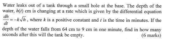

i got k = ln |9/64|
then how can the next step using ln 0 doesn't make sense. what should i do?
kyu said:
i got k = ln |9/64|
Please show us your work.
should be wrong but here goes
dh/dt = -k h^(1/2)
1/h^(1/2) = -k dt
ln 9 - ln 64 = k
ln |9/64| = k
ln 0 - ln 64 = ln |9/64| (t-0)
dh/dt = -k h^(1/2)
1/h^(1/2) = -k dt
Where did the dh go?
kyu said:
ln 9 - ln 64 = k
How did you get this (above)?
kyu said:
ln |9/64| = k
dh/dt = -k h^(1/2)
1/h^(1/2) = -k dt
ln 9 - ln 64 = k
ln |9/64| = k
The integral of [itex]h^{-1/2}[/itex] is given by the usual rule for powers, [itex]\int x^\alpha\,dx = \frac{x^{\alpha + 1}}{\alpha + 1} + C[/itex], not the exception [itex]\int x^{-1}\,dx = \ln |x| + C[/itex].
