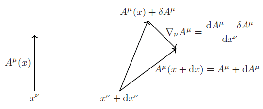

I'm reading 'Core Principles of Special and General Relativity' by Luscombe - the part on parallel transport.
A vector ##v## given at every point of ##\gamma(\lambda)## with tangent vector ##U^{\beta}## is said to be parallel transported if the covariant derivative vanishes at all points of ##\gamma(\lambda)##: $$U^{\mu}\nabla_{\mu}v^{\alpha}=U^{\mu}(\partial_{\mu}v^{\alpha}+\Gamma^{\alpha}_{\ \ \rho\mu}v^{\rho})=0$$
I guess ##U^{\beta}## and ##v## are vector fields instead of vectors as claimed in the quote. Till here I can understand, but then it's written:
Armed with the knowledge of parallel transport, we can complete the picture of the covariant derivative. Let ##\delta A^{\mu}\equiv -\Gamma^{\mu}_{\ \ \beta\nu}A^{\beta}\text{d}x^{\nu}## denote the change in ##A^{\mu}## that occurs in parallel transport through ##\text{d}x^{\nu}## (see fig below).
I want to clarify my understanding of the part in bold. My current interpretation is: we can talk about the value of connection coefficients ##\Gamma^{\mu}_{\ \ \beta\nu}## _only in reference to some chart_, so let that chart be ##(U,x)##.
Initially we consider a vector field ##A## with components ##A^{\mu}## and we start at some point ##p\in U## with coordinates ##x^{\nu}##. The change in ##A^{\mu}##, according to the text, is ##-\Gamma^{\mu}_{\ \ \beta\nu}A^{\beta}(p)\text{d}x^{\nu}##.
But from parallel transport condition, we have ##\partial_{\nu}A^{\mu}(p)=-\Gamma^{\mu}_{\ \ \beta\nu}A^{\beta}(p)## and so, from what the book says, $$\begin{align}
\delta A^{\mu}\equiv\partial_{\nu}A^{\mu}(p)\ \text{d}x^{\nu}&=\text{d}A^{\mu}(p)
\end{align}$$
It seems like I can interpret the differential of ##A^{\mu}## at ##p##, i.e. ##\text{d}A^{\mu}(p)## as the change in value of ##A^{\mu}## as I incrementally move from ##p=x^{\nu}## to ##p'\equiv x^{\nu}+\text{d}x^{\nu}##.
But if you look at the figure, ##A^{\mu}+\text{d}A^{\mu}## and ##A^{\mu}+\delta A^{\mu}## are different, and so ##\text{d}A^{\mu}## and ##\delta A^{\mu}## are different, contradicting the equation I wrote above.
Where am I going wrong?
That's because they are describing two different things.
##A^{\mu}+\text{d}A^{\mu}## is describing the actual value of the vector field ##A^\mu## at ##x^\mu + \text{d} x^\mu##, as compared with the value of the vector field ##A^\mu## at ##x^\mu##.
##A^{\mu}+\delta A^{\mu}## is describing what you would get if you took the value of the vector field ##A^\mu## at ##x^\mu## and parallel transported it to ##x^\mu + \text{d} x^\mu##.
They are different because the covariant derivative of ##A^\mu## is not zero.

Once again, Luscombe's exposition can be a bit confusing. He says
Luscombe (caption to fig 14.4 on p 254) said:
Figure 14.4
##A^\mu (x)## is parallel transported from ##x^\nu## to ##x^\nu + dx^\nu##, picking up an extra component ##\delta A^\mu## . The covariant derivative is the difference ##A^\mu(x + dx^ν ) − (A^\mu (x) + \delta A^\mu)##.
What's really meant is the difference between the parallel-transported version of ##A^\mu## and the coordinate-translated version. Your equation is correct if and only if ##A^\mu(x)## is in fact a covariantly-constant vector field along the ##\nu##'th coordinate direction.

PeterDonis said:
You assumed that ##A^\mu + \text{d} A^\mu## is what you get by parallel transporting ##A^\mu## from ##x^\mu## to ##x^\mu + \text{d} x^\mu##. It isn't.
I'm afraid I still don't get it. The book mentions that the vector ##A## is being parallel transported through ##\text{d}x^{\nu}##, which means that the covariant derivative of ##A## vanishes through whatever part of the ##x^{\nu}## coordinate curve it's being parallel transported. So in that case, the vectors ##A^{\mu}+\delta A^{\mu}## and ##A^{\mu}+\text{d}A^{\mu}## should coincide, as opposed to what's shown in the figure, correct?
Because as I showed in the OP, ##\delta A^{\mu}## as defined by the author equals ##\text{d}A^{\mu}## if we assume the parallel transport condition. I can only guess then that in the quote "Let ##\delta A^{\mu}\equiv -\Gamma^{\mu}_{\ \ \beta\nu}A^{\beta}\text{d}x^{\nu}## denote the change in ##A^{\mu}## that occurs in parallel transport through ##\text{d}x^{\nu}.##", the parallel transport bit is dicey.
The book is comparing the actual value of the vector field at ##x^\mu + \text{d} x^\mu##, which is ##A^\mu + \text{d} A^\mu##, with the value that would be obtained by parallel transporting the vector at ##x^\mu## to ##x^\mu + \text{d} x^\mu##, which is ##A^\mu + \delta A^\mu##. So there are two vectors being compared, and only one is obtained by parallel transport.
You are looking at it backwards. What the book is trying to explain is that the covariant derivative does not vanish, if the actual value of the vector field at ##x^\mu + \text{d} x^\mu## is different from the value you would get by parallel transporting the vector at ##x^\mu## to ##x^\mu + \text{d} x^\mu##.
It seems like you already understand this, so the real issue appears to be that the book's wording isn't very clear. If that's the issue, I agree it isn't very clear.

Shirish said:
if ##A^{\mu}## are the coordinates of ##A(p)##, then ##A^{\mu}+\text{d}A^{\mu}## will be the coordinates of ##A(p')##, right?
No. ##A^\mu## is a vector field, not coordinates. The coordinates of ##p## are ##x^\mu##, and the coordinates of ##p'## are ##x^\mu + \text{d} x^\mu##. "The coordinates of ##A(p)##" makes no sense; what makes sense is something like "the value of the vector field ##A## at the point ##p## is ##A(p)##".

Shirish said:
I meant components of the vector field
So you're asking if ##A^\mu + \text{d} A^\mu## are the components of the vector field at the point ##p'##? Yes, that's correct.

Shirish said:
I'll attempt to prove that.
There's nothing to prove; it's true by definition--the book is defining ##A^\mu + \text{d} A^\mu## to be the value of the vector field ##A## at the point ##p'##.

Shirish said:
so I'm not to interpret as the differential of the smooth function ?
First, ##A^\mu## is a smooth vector field, not a smooth function.
Second, it depends on what you mean by "differential". See below.
Shirish said:
I was interpreting the relation as $$A^{\mu}(p')=A^{\mu}(p)+\text{d}A^{\mu}(p)$$
Yes, that's what the book means when it says ##A^\mu (x + \text{d} x) = A^\mu + \text{d} A^\mu##.
Shirish said:
if the last term is indeed the differential of ##A^{\mu}## at ##p##, then this relation probably needs to be proved
What do you think "the differential of ##A^{\mu}## at ##p##" means, and why would it not be true by definition that ##A^\mu (x + \text{d} x) = A^\mu + \text{d} A^\mu##?

Shirish said:
So the way I'm thinking about it is:
$$\text{d}A^{\mu}(p)=\bigg(\frac{\partial A^{\mu}}{\partial x^{\nu}}\bigg)_p\text{d}x^{\nu}$$
where ##\{\text{d}x^{\nu}\}## is the chart-induced cotangent basis at ##p##.
No. When the book says the coordinates of the point ##p'## are ##x^\mu + \text{d} x^\mu##, ##\text{d} x^\mu## is not the cotangent basis at ##p##. It's just a way of writing the infinitesimal difference in the coordinates between ##p## and ##p'##. The notation ##\text{d} x^\mu## is unfortunate since it is the same notation that is also used to denote the cotangent basis at ##p##, but that's the notation the book chose.
Similarly, when the book writes ##\text{d} A^\mu##, it does not mean the differential of some function at ##p##. (Note that the book does not use the functional notation ##dA^\mu (p)## that you are using.) It just means the infinitesimal difference between the value of the vector field ##A## at ##p## and the value of the vector field ##A## at ##p'##.
Aiiii NOW I get it. I swear differential geometry notation is a colossal pain in the neck! And I'll probably switch to another book now.
