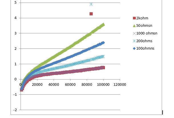

I have a Tektronix current probe TCP305A w/ TCPA300 amplifier and a standard 10x voltage probe. After speaking with a friend about proper grounding practices, I was able to keep my phase error between -0.5 and 0.5 degrees between 1kHz and 100kHz. On an impedance analyzer(extremely accurate), my resistor has phase of 0.2degrees in this bandwidth.
My goal is to get within 0.1 degrees phase difference from what I measure on the impedance analyzer, with little jitter. From my analysis so far, I have some thoughts
1) Impedance analyzers have extremely stable input signals. Function generators do too, but it is not good enough.
2) The ground loops (ground reference will be slightly different in the circuit,at the oscilloscope, and the function generator due to cables), therefore phase cannot be measured so accurately because the probes will always disturb circuit
3) I have seen that for slightly different grounding (changing the order/position of the probe ground clips, and the input ground clips) the phase can be altered as much as 0.3 degrees or more. At this rate, it is no practical to believe the oscilloscope, because small changes can really affect the measurement of phase. This is not really a problem for a resistor, however, small phase error (eg -90.4 phase vs -89.4 phase) for a capacitor can be the different between positive and negative power!
I think I need to try the differential probe because grounding seems to really affect the phase measurement, although theoretically I can design the experiment such to avoid the issue.

I tried a differential voltage probe, it did not fix the problem. I know that my problem is not delay because the delay times vary with frequency. The phase error has a strong dependence on both the impedance of the DUT and the frequency. Also, the error is way beyond reasonable delay differences.

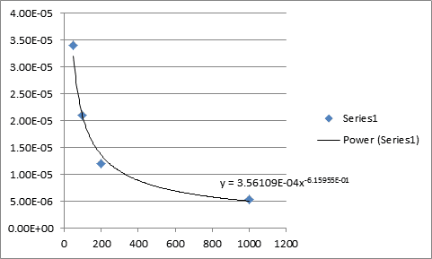

Take a look at some data for frequency sweep using different precision non-inductive type resistors. The y-axis is phase and x-axis is frequency. The setup is red wire, then,voltage probe, then resistor, then current probe, then ground (ground for the signal, voltage probe, and current probe). I get parabolic shape type trends when connecting the current probe before the resistor.
The curves below show a trend. If I plot the slopes of the linear portions, I get a decent looking prediction of the slope with a power regression for the slope versus impedance.
I have not seen anyone measuring phase with 0.2 degrees accuracy. I am not measuring tan delta, but my DUT reaches phase of near 90 deg and minus 90 degrees with a large range of impedance (100kΩ to 10Ω) depending on the working frequency.
Is it possible to measure the phase with 0.2 degree absolute error using an oscilloscope?
Right now, my best guess to tackle this phase error issue is to do extensive calibration by measuring the phase error data for a Pot resistor. By varying the pot resistance and doing frequency sweeps, I can get the phase error for a given frequency and impedance. Then I can adjust the phase according to my calibration tests.
I feel that this is too much calibration without a scientific method behind it, but I am out of methods.

I measured the phase vs. frequency for the current probe before the voltage probe.
https://www.physicsforums.com/file:///C:\Users\Husain\AppData\Local\Temp\msohtmlclip1\01\clip_image001.jpg
The curves going from down to up, go in decreasing resistance values (all noninductive precision resistors). The orange dots is for 10ohmn.
It seems that putting the current probe before the voltage probe limits the error seen for low impedance (less than 1 degree) and putting it after the resistor (previous post) limits the error for large impedance.
Another experimental point that I need to mention is that I used 10 windings for the current probe to get a stable current signal for the high impedance values. I did all the experimental with the 10 windings. I did an experiment using comparing a 10ohm with and without 10 wingdings and the values were within 100 milli degrees, so I believe the windings are not the main source of this error.
I also did the same experiments with a 100x probe; nothing to special happened, but slightly different trends were observed
My conclusions/suggestions/thoughts:
Measuring phase within 200milligrees is sort of a dream for an oscilloscope, and I have a sort of new one, agilent MSO6014a. If you would like to get within 1 degree accuracy, the right probe will get you there. However, if you would like accuracy within 100milligrees, you need extensive calibration data of your setup. This means measuring the frequency response of non-inductive resistors for several different values. Then, you can calculate the delay times (as a function of frequency) for each impedance. For a given frequency, fit a logrithmtic regression (excel does this) to the delay vs. impedance. The regression looks like A*ln(frequency)+B=delay.
I don't think the solution lies completely in proper probing, but we need to use a calibration technique, like the one I suggested.
