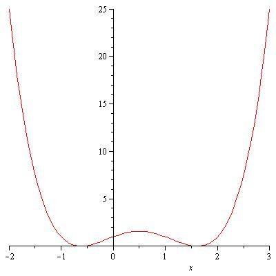

I got it. I considered the function [itex]f(x)=x^4-2x^3-x^2+2x+1[/itex] and proceeded to find it's relative extrema. Since *I* took calculus in high school I figured this was acceptable. :tongue: I did this in the hopes that the graph has no x-intercepts. What I found instead is that one of the critical numbers of [itex]f(x)[/itex] is actually a root of [itex]f(x)[/itex]. Once you have one (irrational) root, you get its conjugate for free. And once you have 2 roots of a quartic you have defeated it, because you have reduced the problem to factoring a quadratic.
Try to follow my steps and see if you can't get it.
I think you can do it my suggested way because I have now done it, and the result also agrees with what you say about there being two double roots.
dirk_mec1 said:
I suspect that a smart substitution is the key.
You suspected rightly: let [itex]x=u+1/2[/itex]. I came across that by noticing that the function [itex]f(x)=x^4-2x^3-x^2+2x+1[/itex] has its relative minima at [itex]x=(1\pm\sqrt{5}/2[/itex] and a relative maximum right smack in the middle of them at [itex]x=1/2[/itex]. That means the function is symmetric about the line [itex]x=1/2[/itex].

Yes, that agrees with what I got. If you can't see what the substitution should be then try to generate the graph of the function using Calculus I techniques (that's what I did). If [itex]x=a[/itex] is an axis of symmetry of the graph of [itex]y=f(x)[/itex] then [itex]u=x-a[/itex] is a good substitution. I saw that the graph of the function [itex]f(x)=x^4-2x^3-x^2+2x+1[/itex] has the line [itex]x=\frac{1}{2}[/itex] as its axis of symmetry, so presto. The graph is attached for your viewing pleasure. :tongue:
