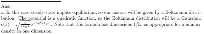

N particles diffuse in one dimension in the potential U(x) = ax^2, with a > 0.
Find steady-state concentration, c0(x).
No idea how to solve this. Any equations?
Here's the answer
I still don't understand HOW they obtain that expression...
