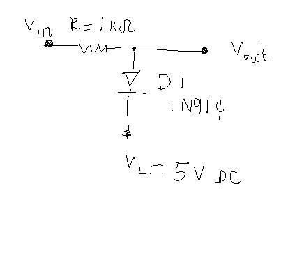

How do I construct a circuit that will limit the positive half of a 20V peak-to-peak sine wave to 5.6V and the negative half to -2.5V?
So far, I have a 1 k ohm resistor and the diode is forward biased leading to VL and Vout.
