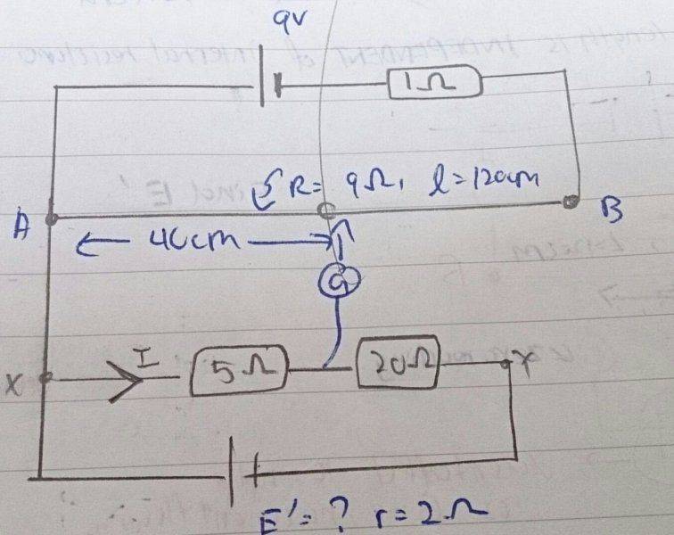

when the balance point is achieved , there're no current passing thru , so Galvanometer should show 0 . Am i right... so there's no current passing thru the 20 ohm resistor . so my working is ( 8.1/120 )(40) = 2.7 V ...
correct me if I'm wrong...
V_xy = V_ac = (9/10) x 10 = 8.1v
k = 8.1/120
V_xy = k (40) = 2.7v
(5/ (5+20+2) ) X E " = 2.7 V
E" = 14.58v[/B]

What is the problem statement ?
No. It only means there is no current passing through the galvanometer.
Likes werson9339
No current passing through the galvanometer means there is no potential difference over the thing. If we call the point between the 5 ##\Omega## and the 20 ##\Omega## resistors point z: VAC = VXZ.
For VAC you have the right result (but perhaps a typo?) : VAC / VAB = 40/120 and VAB = 9V * 9/10.
And for E' (single quote in the drawing) you also have the right result.
