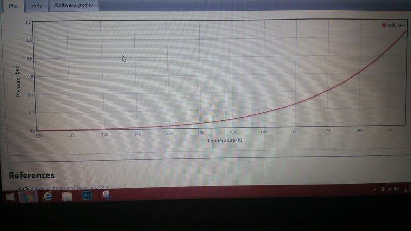

The vapour pressure for nitrous oxide at 180K is around 0.6152 bar. I don't mind the assumption that the system is adiabatic but I think the system should not be isothermal as the tank will cool as the vapoursied fluid leaves the tank. As for gravity I am not sure. I only really care about solving this problem as a one dimensional problem, so the stream line can be considered going straight in the axial direction of the orifice.(accuracy is not overally important here otherwise I would have just used CFD).
So, if the pressure is 0.6 bars, what would cause the liquid to come out of the tank?
This graph was taken from the NIST webbook and shows a vapour pressure of 0.6 bar at 180K, ok so maybe the liquid does not vapourise in the tank but the liquid must come out because you have a pressure difference of 49 bar across the orifice.

What is it pressurized with? You'd need some sort of pressurized gas in the headspace to achieve this - if the headspace is just gaseous nitrous oxide, it can't maintain 50 bar at 180K, since it'll just condense onto the liquid surface until it is at the vapor pressure of 0.6 bar. If you're talking about a hybrid rocket tank, you generally wouldn't refrigerate it for this reason - you'd rather have the nitrous at 315K or so to allow it to self-pressurize the volume above the liquid.
OK. Here's how this plays out, including gravity. When you first open the valve on the bottom, a small amount of liquid will leak out until the N2O has decompressed to the point where the pressure at the top of the liquid has dropped to 0.65 bar. From that point on, a vapor phase will form above the liquid, and the liquid pressure will rise with depth. The Bernoulli equation for this situation will be
$$65000+\rho g h+0=100000+0+\frac{1}{2}\rho v^2$$where the left side of this equation applies to the top liquid surface, the right hand side of the equation applies to the exit orifice, ##\rho## is the fluid density, h is the liquid level in the tank, and v is the liquid velocity coming out of the exit orifice.
