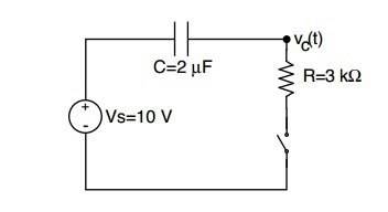

The voltage across the capacitor is 10V when t<0
The switch is closed at t=0
I have to find the diff eq. in terms of Vs, C, R by balancing the current at node Vc(t). But i am not sure whether the Vs is 0 or 10V at t<0
I am assuming Vs = 0 at t<0 since the voltage across capacitor is 10V. Also, I am not sure what current balance at the node means...I mean when the switch is closed the current through the capacitor is the same as current through the resistor. So,
iR = iC
(Vc/R) = C (dVc/dt)
How do i write this in term of Vs? Isn't the current through the resistor Vc/R since Vs is 0 at the beginning?

I'm not sure what you mean when you say "I am assuming Vs=0...". I think you mean that you are assuming that the voltage at the negative end of Vs is zero - which would be a fine assumption. It doesn't really matter what point you take as your "ground" or zero voltage level.
If you take Vs- as zero, then obviously Vs+ will be "Vs" and Vc(0) will be at (Vs-10v). Or, perhaps, (Vs+10V), since the polarity of the voltage across the capacitor is not explicitly specified.
Are you sure this is what it says--"across the capacitor"? Can you quote precisely the wording of the question?
You have to specify the polarity of the 10V across C before proceeding with the problem. It could be +10V or -10V.
Since the source is not mentioned in the problem statement you should asume it stays at +10V for all time -infinity to +infinity.

In this specific scenario, since the voltage across the capacitor is 10V at t<0 and the switch is closed at t=0, we can assume that Vs = 10V. This means that the initial voltage across the capacitor is 10V and it will start to discharge once the switch is closed.
The current balance at the node refers to the Kirchhoff's Current Law, which states that the sum of currents entering a node must equal the sum of currents leaving the node. In this case, the current through the resistor and the current through the capacitor must be equal.
Therefore, we can write the differential equation as:
(Vs - Vc(t))/R = C * dVc/dt
Where Vs is the initial voltage across the capacitor and Vc(t) is the voltage across the capacitor at time t.
