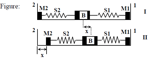

A block (B) is attached to two unstretched springs S1 and S2 with spring constants k and 4k, respectively (see figure I). The other ends are attached to identical supports M1 and M2 not attached to the walls. The springs and supports have negligible mass. There is no friction anywhere. The block B is displaced towards wall 1 by a small distance x (figure II) and released. The block returns and moves a maximum distance y towards wall 2. Displacements x and y are measured with respect to the equilibrium position of the block B. The ratio y/x is
I don't really know how to do this, but here's what I know:
From energy conservation, 1/2 k x2 + 1/2 (4k) x2 = 1/2 k y2 + 1/2 (4k) y2
So, I get y=x.
Which isn't the answer. The answer is (C).
I don't understand why.
What's (C) mean?
Oh sorry, I meant the answer is 1/2
Hint : Energy conservation is the correct method to use here. Application, though, is wrong.
When you move B x to the right, consider M2 and B to be one system(Why?).
Similarly, when B moves y to the left, consider M1 and B to be one system(Why?).
The reasoning for this can be obtained from diagram II.
