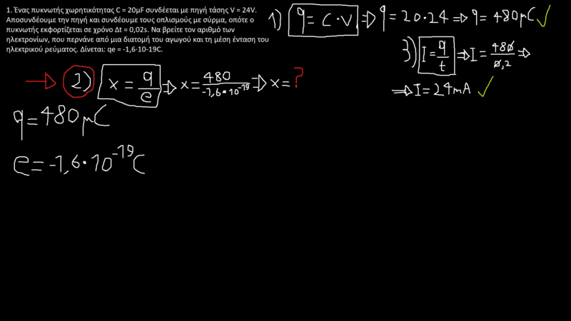

Dividing 480/(-1.6x10^(-19))
  • Thread starter HazyMan
  • Tags
    division
In summary: All i did was 48/16 (i took out the 0 from 48) which gave me 3. then i added the 0 that i took, and put it in -20-, which gave me -21-. That's how i came up with...In summary, a capacitor with a capacity of C=20μF is connected to a source with a voltage of V=24V. We unplug the source from the capacitor and we then connect it with a wire and the capacitor gets charged in a time of Δt=0.2s. The number of electrons that pass go to the capacitor and the current is q=C⋅V and x=q/e.
HazyMan
51
Member advised to use the formatting template for all homework help requests
1. A capacitor with a capacity of C= 20μF is connected to a source with a voltage of V=24V. We unplug the source from the capacitor and we then connect it with a wire and the capacitor gets charged in a time of Δt=0.2s. Figure out the number of electrons that pass go to the capacitor and the current. Given: -1.6x10-19
2. q=C⋅V , x=q/e , I=q/t
3. A picture should be somewhere in the forum, showing a solution attempt. By the way, i am only stuck at question 2). I only need to learn how to divide such kind of numbers and then the exercise will be complete.
The trick is to write the quotient in terms you can handle: What does ##\mu ## mean? Where are the Coulombs in the denominator have gone to? Can you write ##1.6 \cdot 10^{-19}## as ##16 \cdot\ldots \,##? How would you handle ##\dfrac{a\cdot b}{c \cdot d}## if ##c\,|\,a## and ##d\,|\, b\,?##

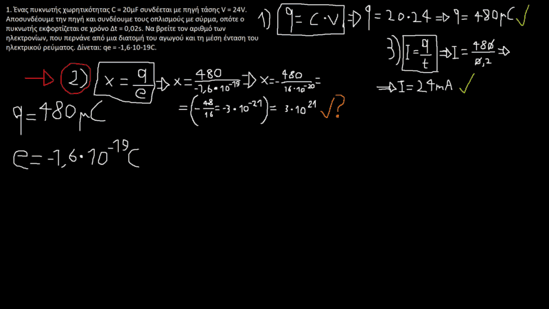

ok so I'm replying late, but: μ= 1/106.
now what is left is finding what the Z is
EDIT: I figured out the Z to be -20.
1.6x10-19=16x10-20
Today i came up with this. Is it correct?
The ##3## is correct, but you have to collect the right number of digits, will say powers of ##10##. And, yes, ##1.6\cdot 10^{-19}=16\cdot 10^{-20}##. So we have ##-x=\dfrac{480\,\mu C}{1.6\cdot 10^{-19}C}= \dfrac{480\,\mu C}{16\cdot 10^{-20}C}= \dfrac{480}{16}\cdot \dfrac{\mu}{10^{-20}}\cdot \dfrac{C}{C}\,.##
Now where has the ##\mu## gone to? And what is the power ##n## in ##\dfrac{480}{16}= 3\cdot 10^n\,?##
Although your notations are a bit confusing, I think you have everything write (##n=1\; , \;\dfrac{1}{10^{-20}}=10^{20}##), except that you seem to have forgotten the micro!

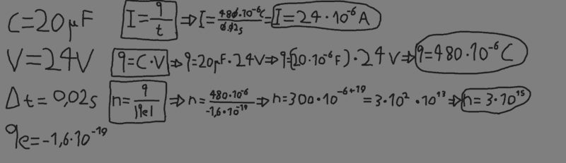

I finally managed to understand where i went wrong.
This is what i came up with. (I initially thought of taking 300x1013 altogether and take the 0 zeroes from the 300 and put them on the 13 which would give me 3x1015 but i thought it was wrong. However it realized that both methods work, but i used yours anyway.
Thanks a lot for your help!
