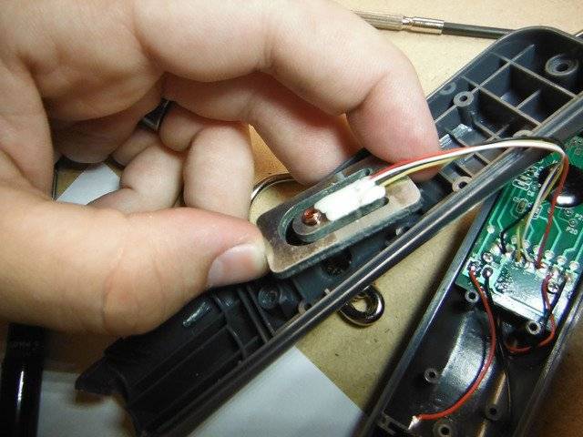

Well, I found a Quarrow fish scale at the local fish shop for 14 dollars, so decided that was cheap enough to risk. Inside looks like actually a small strain gauge with 4 leads.\
It gives a negative reading on the LCD display for pushes so I think it might work, but its only accurate to 50 grams. Reading this awesome page I assume the relevant electronics are a Wheatstone bridge and amplifier, so if I can't just splice a wire somewhere I could build my own circuit fairly easy. I'm not sure if the more expensive Vernier sensor uses a similar strain gauge...I was thinking there was some other technology used for some reason.
So now I am guessing under the gunky white stuff on the load cell there is already a wheatstone bridge. I supplied 3.3V to the red wire while reading voltage across the white and yellow wires. Just sitting on my desk it read 0.1 mV. When I squeezed it (to the point of pain in my fingers) it climbed up to 0.4 mV. Letting go the voltage dropped back to 0.1 mV.

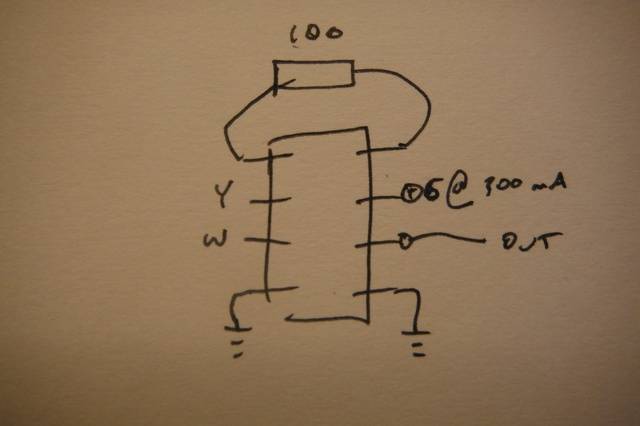

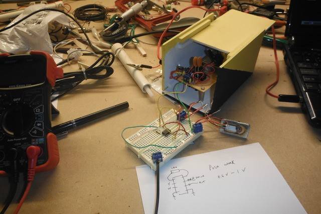

Finally got a few INA126 in the mail. Very happy to share with you some success with this project. I used a 6V 300mA wall wart for power and a 100 ohm resistor to set the gain near 1000. This took my tenths of a millivolt readings up to tenths of a volt as desired (getting a range of around 0.6 to 1 V for pushes). I fed the output through a chopper (this insanely handy circuit) and the chopper into my laptop microphone jack. Using RadioSkyPipe2 I plotted the following:

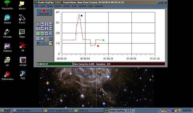

Here the blue is me pushing slowly as hard as I can. The red is me pulling as hard as I can (its harder to pull since its just a little rod at the moment). The green is just sitting on my workbench. I'm ecstatic! I likely did not wire the INA126 in an optimal fashion, to be honest I am confused about the 5 pin. Here is what I did (the Y is the yellow line coming from the bridge, W is the white line):
Any suggestions on that front are most welcome, although as is it the circuit seems to be doing everything I had hoped for. Finally here is a pic of the super sloppy breadboarded circuit and bridge sensor, to be cleaned up later of course:

What is voltage on your Y and W wires?
Reason i ask is - opamps like to have a little "headroom" between their input pins and their power supply pins.
Look at datasheet here
http://courses.cs.tamu.edu/rgutier/ceg499_s02/sbos062.pdf
(the one from TI isn't displaying characters correctly in my version of acroobat)
page 4 bottom right chart labelled "Input common mode voltage range vs output voltage, Vs=+/- 5"
What it is showing graphically is this -
This IC likes to see its input pins at least a volt away from both V+ at p 7 and V- at pin 4.
Pin 5 would best be set about halfway between pins 7 and 4,
hence that little dashed rectangle showing locus of "desirable" inputs for single supply of +5volts on pin 7 and 0 volts on 4, with pin 5 halfway between them at 2.5.
Wow that's a mouthful - does it parse okay ?
If you have available a negative supply of a few volts, try setting pin 4 to around negative 5volts.
If not, try setting pin 5 about +2.5.
In either case you'll want your input pins2&3 not very far from pin 5's voltage which ought to be ~midway between supply pins 4&7.
Your INA will thank you for that.
"Headroom" is my colloquial term for that allowable voltage difference between input and power supply pins.
It's given in datasheets as "common mode range" , an oblique term everybody hears but hardly anybody pays attention to until it causes them trouble.

Question, does the graph on page 4 scale in a linear way for supply voltages other than [itex]\pm[/itex]5? My wall wart is actually 8V (despite it being marked 6V). So, my common mode voltage on the Y and W is 4V. Raising pin 5 voltage to also be ~4V required the use of a 1Mohm resistor. This seemed to rescale my push pull graph in a way that clipped off some of the output, I must have hit some saturation range or something. It also raised the output voltage significantly, like a DC bias (is that the point of Vref?) I tried a few other resistors between 5 and ground.
Here the first is with 30kohm, second with 50kohm, and the last with 1Mohm. The push/pull/push at the very end is what I am saying looks clipped (but maybe this is a limitation of the mic input on my computer). The square forms are where I was adding/removing resistors.
I also tried using a few 3.3V battery packs to setup a dual power supply as mentioned (didnt have the stuff to make a dual 5V unfortunately), with pin 5 grounded. Looks good, but again there is some kind of scaling. From my other post above the first push jumps up about 400 units on the graph, but with this setup it jumps up only 200. Is it fair to call that a lower resolution? Is that because of the lower range of input voltage (6 compared to 8)?
4 volts common mode is too much for a 5 volt supply.
But you had eight...that's more headroom for you.
Now to pin 5... observe there's going to be some small current out of it that'll give a drop across any external resistance in series with pin5.
You'd do better to raise pin 5 by use of a lower ohm voltage divider - say a couple of 1K resistors in series across the supply, will give you Vsupply/2 at their junction. better yet would be to use an opamp buffer between the resistive divider and pin 5 for effectively zero ohms in series with pin 5. Here's what they say about resistance in series with pin 5...
I strongly suspect you are running into limits because of your small supply voltage combined with the 4 volts common mode from that Quarry scale.
Were your two bridge input wires nearer zero you'd have done well with the +/-3.3 and pin 5 to common i think.
